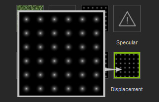

  2. Make sure the object is selected and switch to Modify >> Material >> Texture Settings (in this case, the object has already applied with Diffuse and Blend textures).
  3. Double click the Displacement channel and load a grayscale image. You will be asked to set the type of the loaded image.
  4. Choose the Height Map (Grayscale) radio button and click OK to load the image.
    The object's shape will thus be sculpted. You may need to adjust the UV Tiling values to best fit the displacement image to the object.
    The displacement texture is imported.
    UV tiling values are adjusted.

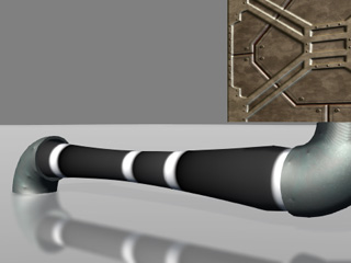

In addition to create still displacement object, you are able to animate the UV settings of the displacement channel to create displacement animations.
  1. Prepare an object (in this case, a pipe between two connectors).
  2. Follow the steps in the previous section to apply a grayscale image to the Displacement channel of the object.
  3. Go to the first frame of the project, set the UV Offset value of the Displacement channel to move the texture so that the extrude area is moved to one side of the prop.
  4. Go to another time frame and set the UV Offset value again to move the texture so that the extrude area is moved to the other side of the prop.
    You will see two keys shown in the Material >> Texture UV track of the prop.
  5. Copy and paste these two keys repetitively so that the extrude area will keep moving from one side to the other.
  6. Play back to view the result.
