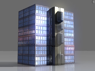

Build a structure in iClone.
Attach the parts together (skip this step if you only want to create a model with
single component and animations).
Make sure the Root node is at the origin of the world (0,0,0).

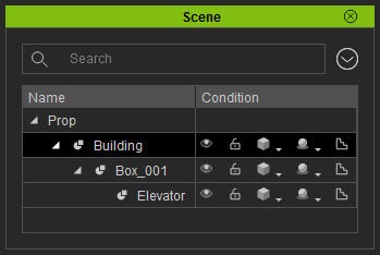

Select the root node of the structure in the Scene Manager (in this case, the
Building).

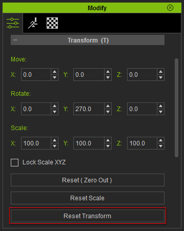

Go to the Set > Prop > Modify panel. In the Transform section, click
the Reset Transform button.

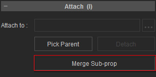

In the Attach section of the Modify panel, click the Merge button.

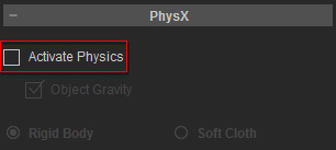

If the animation is simulated using Physics, then you must
open the Object Physics Settings panel (Shortcut: Shift + F9), deactivate the Active Physics box.
This step turns the structure into a common prop.

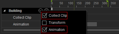

Select the structure. Open the Timeline (Shortcut: F3).
Open the Collect Clip and the Animation tracks of the new structure.
Drag on the Collect Clip track to determine the range of the animation you want to bake into the structure.
Right click within the range and select Add Motion to Library.
The Add to Perform panel will display. Type in the name of the animation and then click OK to Bake the animation into the structure.

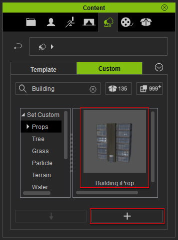

Click the Add button to add the prop into the Custom Library. The
prop can then be loaded into
3DXchange with animations embedded.
