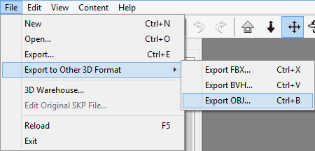

Click the Export OBJ... (Shortcut: Ctrl + B) button in the tool bar, or execute the
File >> Export to Other 3D Format >> Export OBJ...
command to export the mesh with the pose in OBJ file.

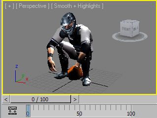

Load the file into any 3D tool (in this case, 3DS Max) that supports OBJ
format.
