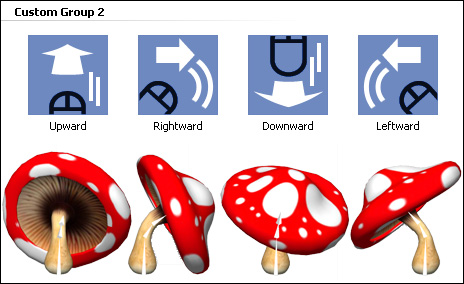

Access the Expression Editor, in the Head tab, clear all settings of the thumbnails.
In the Custom tab,
set the values of each thumbnail by using the blend shape sliders. Group 1: Set the size for the object by morphing. Group 2: Set the directions of the pileus by bones rotating.

The first preset controls the size of the entity.
The second preset controls the direction of the cap.
Select the first preset for morphing the sizes and shapes; select the second preset
for rotating the cap and record the animations.
