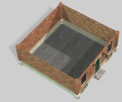

An example of a building generated with compatible pivot points. |

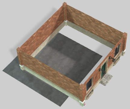

An example of misaligned pivot points. Notice how the floor space is offset by one whole unit. |

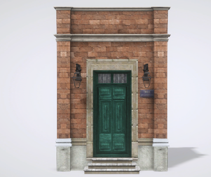

Child elements with correct pivot point positions. |

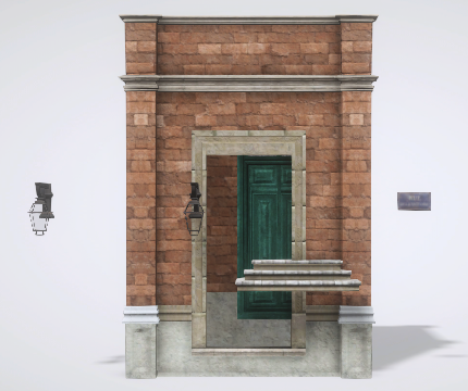

The same child elements with misaligned pivot point positions. |
