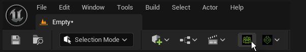

  3. The Mesh file of the character in the Content Browser will be picked.
  4. Click on the CC Setup on the toolbar.
  5. You can then choose to use either one of the shader types for the character.
