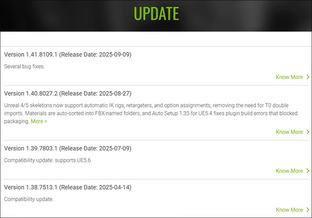

For Previous Version?If your Unreal is of earlier version, then click the Update History button in the previous step.
You can find out the suitable Auto Setup installation files on the list.
