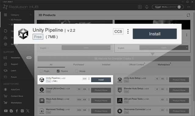

  1. Open Reallusion Hub, choose the 3D Products > iClone or Character Creator product, and click the Install button for the Unity Pipeline plugin.

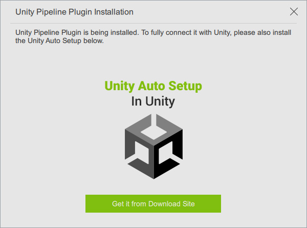

  2. The Unity Pipeline Plugin Installation panel appears. Click the Get it from Download Site button and refer to the Installing Character Creator & iClone Auto-setup for Unity section for further installation instructions.
