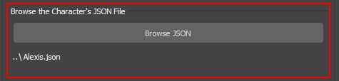

- If the FBX’s JSON file is in the same folder, the Browse the Character’s JSON File section will auto-select. If not, click the Browse JSON button and select the corresponding JSON file.
 to 3ds Max/8.png)

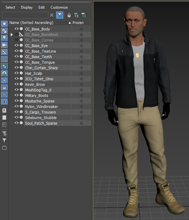

- After the process is completed, your character will appear in the 3ds Max scene.
 to 3ds Max/11.png)
