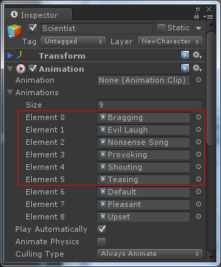

Motion Name: Type in the name of the motions
that have been applied to the actor to have the
actor performs the specific motion.
Note:
Please note that the named motions must be in the animation list of the
actor.
