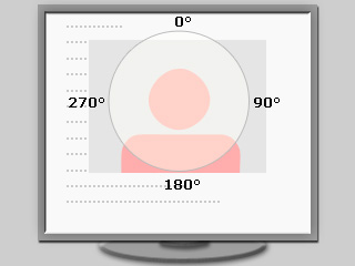

Degree: This value determines the direction the actor will be gazing
in degrees.
The number is from 0 to 360 in float type.

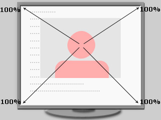

Radius: This value determines the distance for the actor to gaze in percentage.
