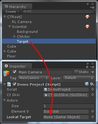

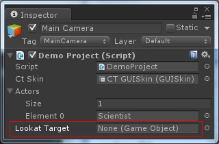

The syntax of the API command that has the actor
start to look at something is as follows:
CTPluginAPI.SetLookAtMode (Mode, Target);
SetLookAtMode:
This is the API command that causes the actor to
track in different modes.
Mode: The mode for the actor to look at the
cursor or a target. The modes can be GameView, FullScreen
or TargetTracking.

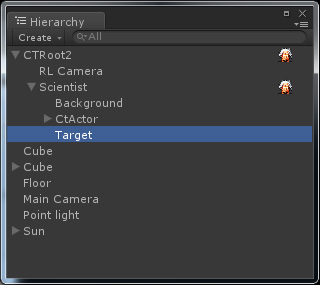

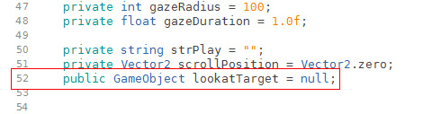

Target: This is a GameObject in Unity. If you
left it unfilled, then the actor will only look at the cursor.
The sliders in the example determine the rolling strength of the eyeballs and the delay time
for tracking when the target (cursor or game object) moves through the two API commands
below:
