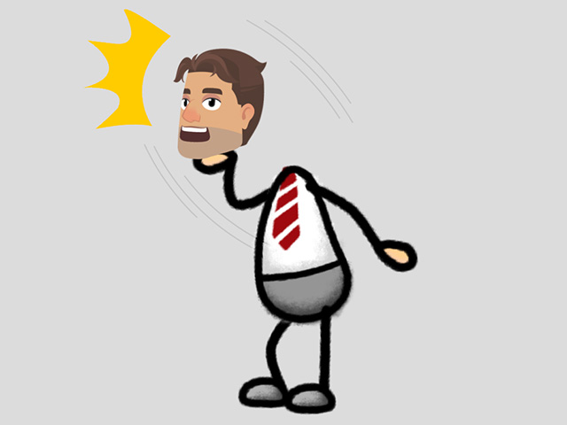

In addition to adding head to the head bone of the body bone structure, you are actually free to put the head to any bone to create a character with totally different style.
- Apply a G3 or G3 360 character on stage and select it.
- Click the Composer
button on the toolbar to enter the Composer mode. - Change the Content Manager to the Head > Head > G3 360 library.
- Drag and drop one of the head templates onto a desired bone (the bone will turn green).
You will be prompted with a warning message that informs you the original head will be replaced since, currently, there can be only one head for a character. Click Yes to replace the head.
- The 360 Head and the target bone are put together afterward.
- Transform the head to ideal position, size and angle.
- Switch back to the stage and the character is ready to animate by setting keys or motion clips.
Playback to view the final result.
