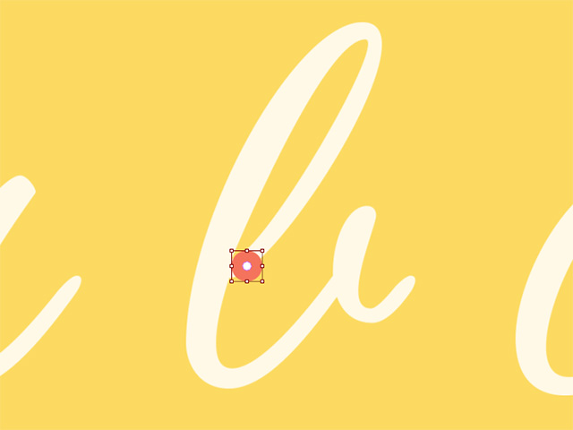

- Create a scene and an object for puppetry.

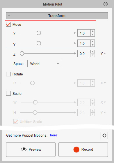

- Make sure the object is selected and enter the Motion Pilot mode.
- Drag the X and Y sliders to determine the sensitivity for
puppetry (1.0 to 1.1 for best results).

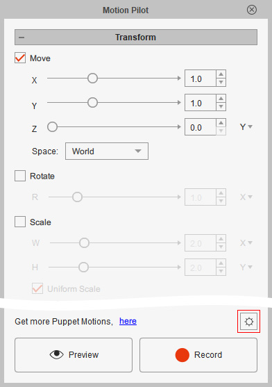

- Click the Puppet Settings gear icon.

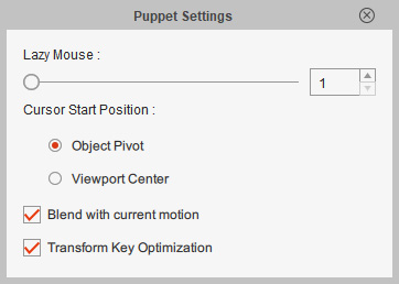

- Set the Lazy Mouse to 1.

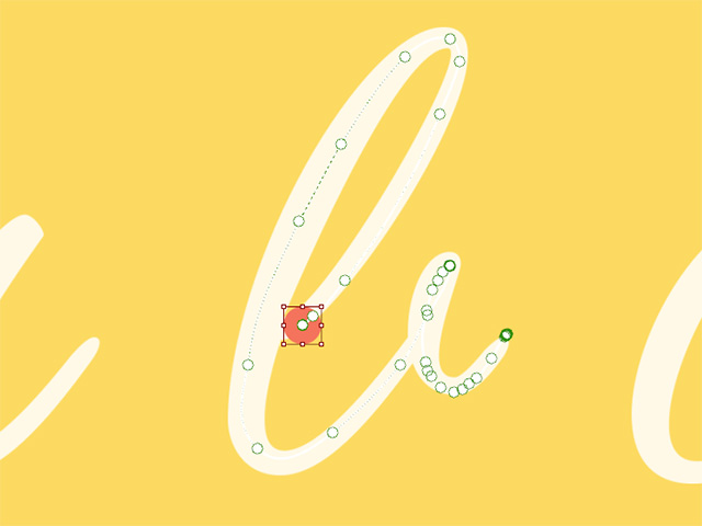

- Close the Motion Pilot panel and select the object. As you can see the object's transform path turns out to be jiggling and unsteady.
- Open the Motion Pilot and the Puppet Settings panel again. Set the Lazy Mouse to 32.

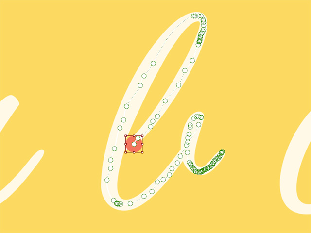

- Close the Motion Pilot panel and select the object. As you can see the object's transform path is smoother and more steady.
