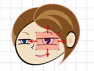

Click on any facial feature. A transform handle box will then appear around the selected feature.
Move your cursor to inside of the box, and drag to relocate the
feature.

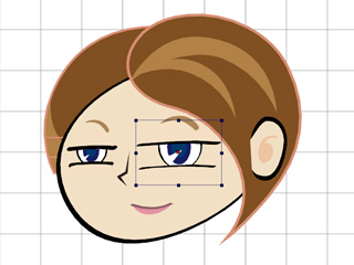

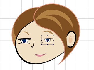

You may drag the eight control points around the box to change the size of the
feature.
Please note that the four points on the corners will help change the size while maintaining the current ratio.

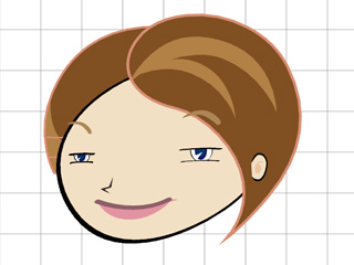

You may use the same method to modify all facial features.
