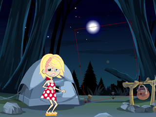

Select a prop. (If you want to select an image layer, then select it from the Scene Manager)
By default, the
Opacity of a
prop is 100. Change it to 0 (zero).

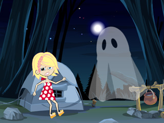

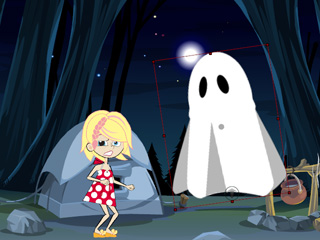

Go to another time frame where you want the selected prop to fade in. Change the Opacity value of the
item to 100. Play back to see the prop gradually appear.
Opacity = 50
Opacity = 100
