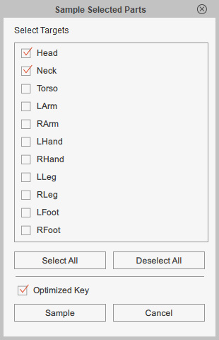

- For Selected Parts:
users can select body parts and spread only related keyframes, which are simplified by preset.
One can locate the intended keys easily and edit the motion.
If you want to optimize the sampled keys, then choose the Optimized Keys for all parts or activate the Optimized Key option inside the Sample Selected Parts dialog box. This method will automatically group keyframes for the same motion and display simplified keys for users to identify and optimize with the 2D Motion Key Editor.

Only the selected body parts will be sampled. In this case, Head and Neck. And the Optimized Key option is activated.
The sampled keys will be optimized.
Only the Selected body parts will be sampled and the Optimized Key option is Not activated.
The sampled keys will NOT be optimized.
