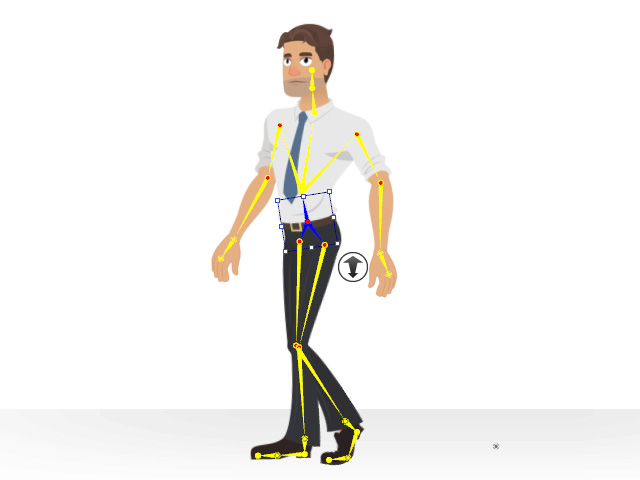

- Go to a desired frame where you wish the character to make a turn to the other side.

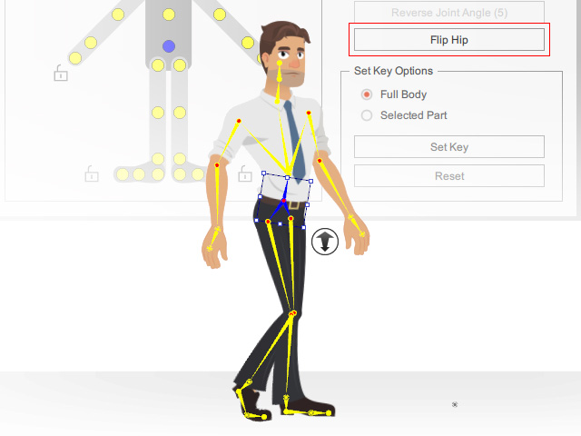

- Click the Flip Hip button.
As you can see the character flips to the opposite direction of the Hip.

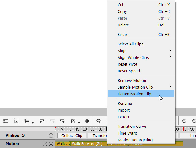

Right click on the motion clip and execute the Flatten Motion Clip command from the context menu
to merge the Flipping keys into the motion clip.

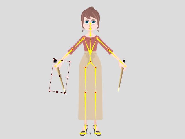

- Create or apply a character, and attach a prop (like this pointer stick) to the character's left hand.

- Go to a desired frame where you wish to flip the character motion. Click Flip Hip button.

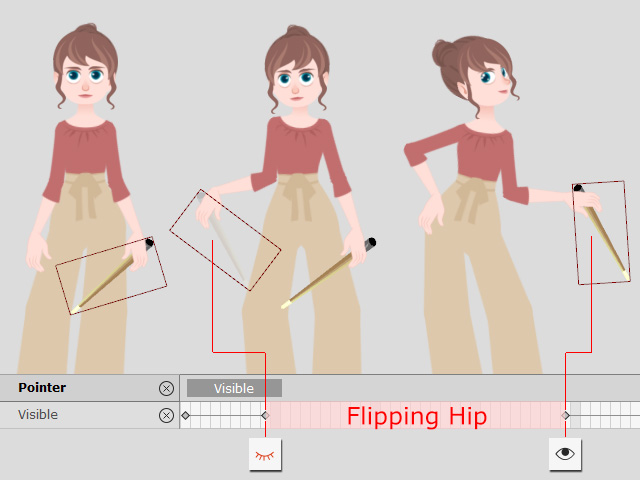

During the flipping hip period, the prop attached on the character's left hand went to the right hand.
- To fix the result, go to the Composer and attach a same prop to the character's right hand.
Back to the Stage.
Hide the prop attached on the right hand in Frame 0 until the frame you set a Flipping key on the bones.
And hide the prop again whenever you set a Flipping key.
Next hide the prop attached on the left hand whenever it shows on the opposite bone.
And show the prop again whenever it is hidden on the opposite bone.
Play back to observe the animation result.
