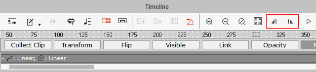

- The hotkeys: Mark in (Ctrl + [ ) / Mark out (Ctrl + ] )
- The buttons on the Timeline Toolbar.

Click the Set Start Frame button on the timeline to move the start marker to current time-frame.
You will see the start marker snaps to the current frame instantly.
- Go to the time-frame as the end of the motion you want to save.
Click the Set End Frame button on the timeline to move the end marker to current time-frame.
You will see the end marker snaps to the current frame instantly.
