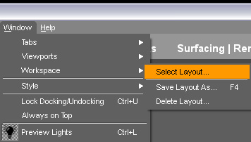

Select the Window >> Workspace >> Select Layout command.

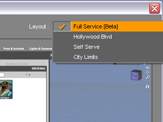

Make sure you choose the proper layout from the Layout drop-down list.

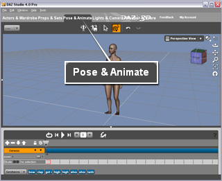

Show the animation timeline:

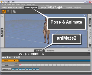

If you are using the Full Service [Beta] layout, then switch to the Pose & Animation tab.
If you are using the Hollywood Blvd layout, then switch to the Pose & Animation tab and

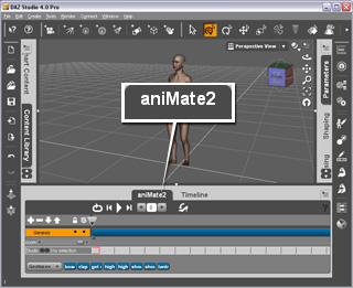

click on the aniMate2 tab.

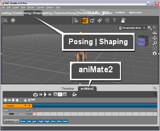

If you are using the Self Serve layout, then switch to the Posing | Shaping mode and
If you are using the City Limits layout, then click on the aniMate2 tab.

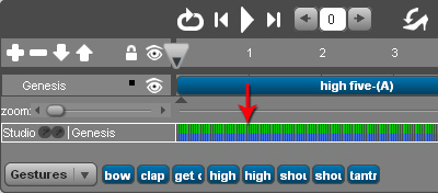

- Apply poses or motion clips to the character.

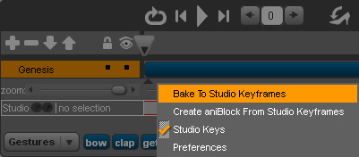

Right-click on the blank space, activate the Studio Keys and select the Bake To Studio Keyframes command.
The pose and motions will be converted into motion keys.

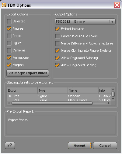

Exporting to FBX - Export Settings
Once the motions are added, then you may export the character, along with the motions, into FBX or BVH formats.
- Go to File >> Export....
- Browse the location for saving the file. Give the file a name and click the OK button.
An FBX Options panel shows.
- In the Export Options, make sure the Figures and Morphs boxes are activated.
- Activate the Animations box.
- In the Output Options, select the FBX 2012 -- Binary from the drop-down list.
- If you want to include the additional cloth meshes, then activate the Merge Clothing Into Figure Skeleton boxes.
- If you want to include the texture images, then activate the Embed Texture.
- Also, activate the Allow Degraded Skinning and Allow Degraded Scaling boxes.
- Click the Accept button to export the motion along with the character.
