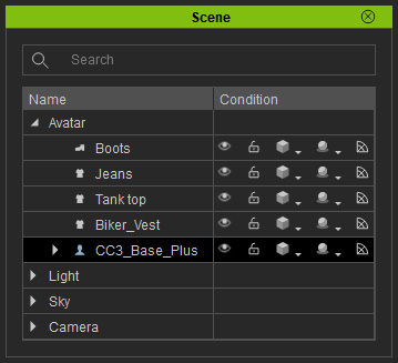

- Select the character from the Scene Manager.

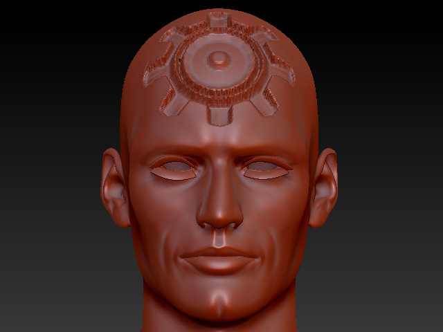

C:\Users\Public\Pixologic\GoZProjects\Default - Paint with the tool on the canvas in ZBrush.

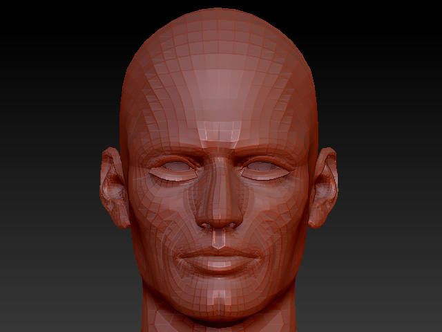

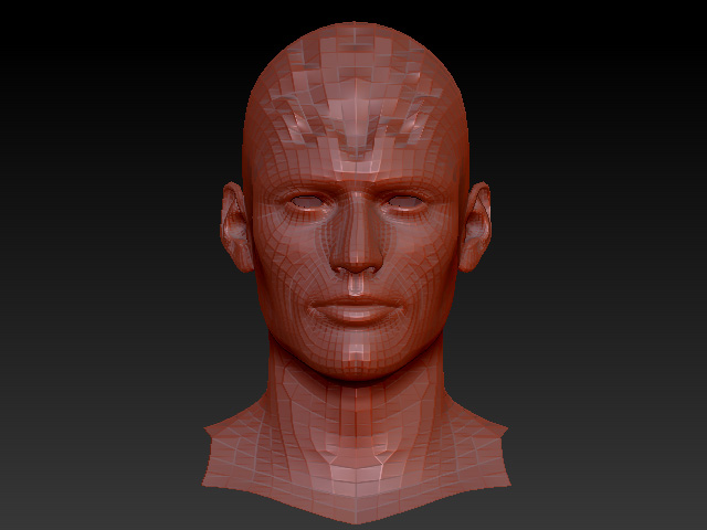

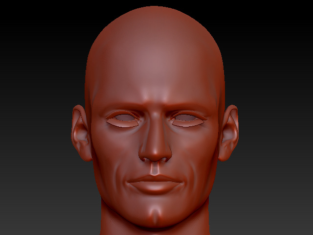

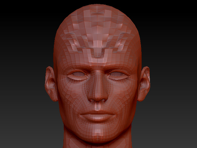

- Subdivide the mesh to at least 3 levels (in this case, SDiv 4) by clicking the Divide button.
The meshes will be smoothed.
- Use the tools to morph the mesh (DO NOT use the append brushes to add elements onto the meshes)
- Drag the subdivision slider (SDiv) to level 1 again, it turns back to the original topology of the mesh.

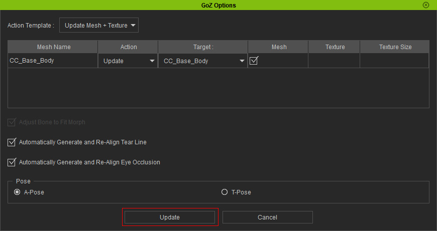

- Press the GoZ button on the ZBrush to send the model back to Character Creator.
- Click the Continue button in the upcoming message box.
- Click the Update button when the dialog box shows in Character Creator.

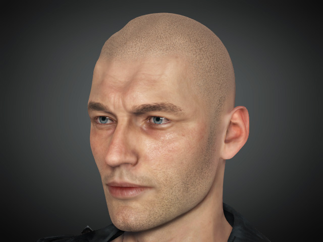

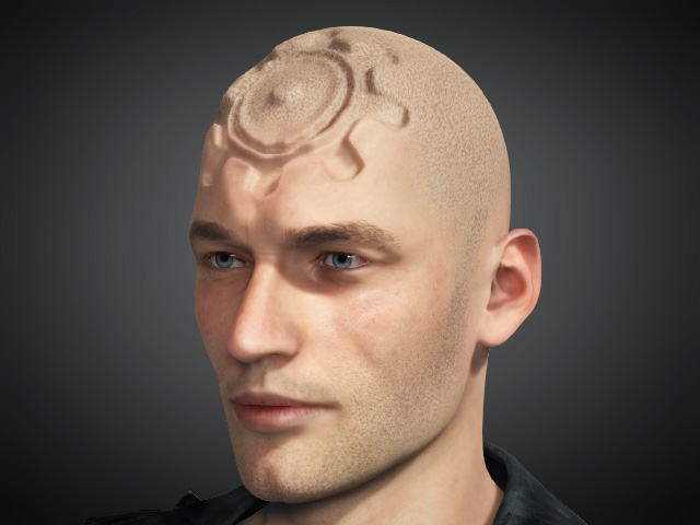

- The character will be updated by the new shape sculpted in ZBrush.

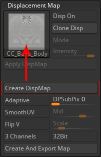

- Open the Displacement Map cabinet and click the Create DispMap button to generate the Displacement map for this mesh.
Click the Clone Disp button to load the map to the brush shelf on the left.

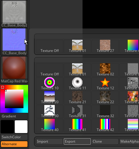

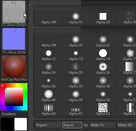

- Press on the Displacement thumbnail, and click the Export button to save it as a grayscale image.
- Press on the Normal thumbnail and click the Export button to save it as a normal map image.

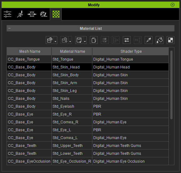

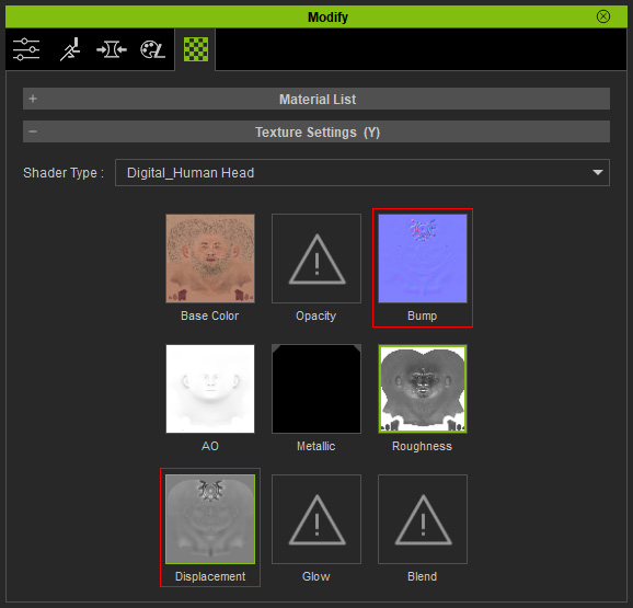

- Go to Character Creator, make sure the character is selected.
- Switch to the Material tab in the Modify panel and select the Head material from the list.
- In the Texture Settings section, load the exported normal map to the Bump channel and the displacement map to the Displacement channel.
Note:- For the Normal map, you may need to activate the Flip Normal Y box in order to have the best bump effect.
- For the Displacement map, you can increase the Strength to enhance the displacement effect.
