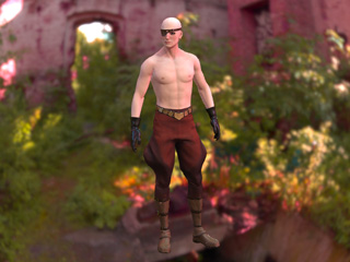

Color Adjustment
Modify the color settings of the IBL image to quickly change the tone of the scene.
Create a new project and optionally apply a custom IBL image (in this case, the default IBL
image is used).
Adjust the parameters in the Adjust Color panel.

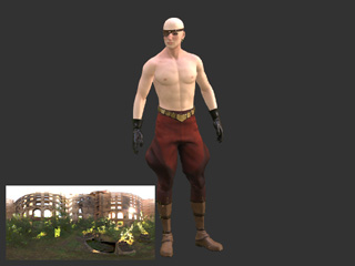

Using External Image Editor
You can also adjust the IBL image with any external image editor.
Given a project in which all the lights are out.
Activate the Activate IBL box to use the default
IBL.
- In the Image Based Lighting section, click the Launch button to invoke the external image editor (in this case, Photoshop).
Modify the image.
Save the image and switch back to Character Creator.
Repeat steps 2 and 3 until you are satisfied with the results.

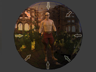

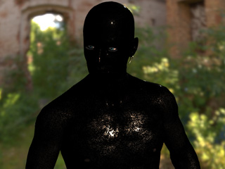

Note:- IBL does not create shadows.
- You may set Transform keys for the IBL sphere to adjust the location, angle, and size of the light source.

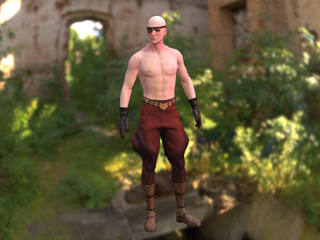

Softness of IBL
The image applied for IBL sometimes maybe too sharp, especially when you are using an HDR image, which can cause the IBL look like it is projecting textures onto objects. Character Creator provides a softness feature to help you blur the IBL image.
IBL = OFF |
IBL (*.hdr format) activated Softness = 0 |
Soften the IBL source texture Softness = 15 |
