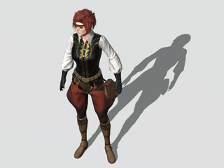

Prepare a project with default light. Activate the Shadow option.
If the shadow is not very strong, then continue with the following steps.

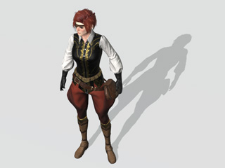

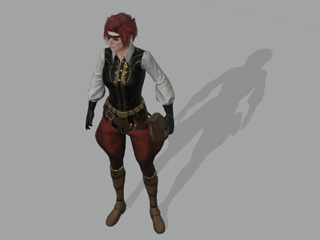

Switch to the Atmosphere tab in the Visual Settings panel,
and select a darker color for the Ambient Light in the Ambient Light section.

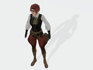

Select the light in the Scene Manager.
Go to the Modify panel and increase the light strength
by increasing Multiplier in the Light section.
Click the Shadow Settings button to increase the shadow Opacity in the Visual Settings panel.
