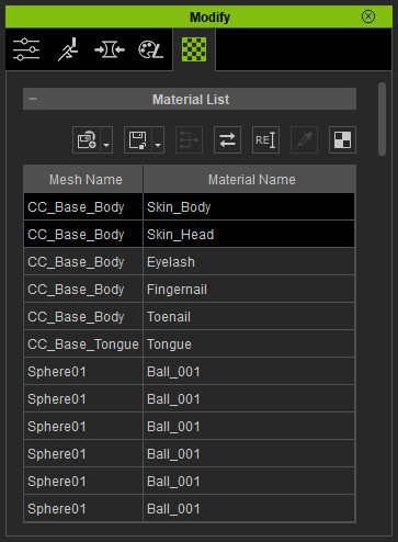

Go to the Modify panel >> Material tab >> Material List section, select the material related
to the skin of the character.

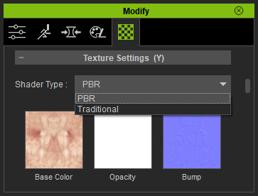

In the Texture Settings section, switch the Shader Type to PBR from the drop-down list.

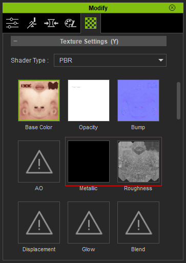

The skin materials of the head and body are thus converted to PBR instantly. You will see the Specular channel
in the Traditional Shader Type is replaced with Metallic and Roughness channels.
Note:At this step, you will not see obvious changes on the skin because the Metallic texture is completely black, which indicates the skin is currently unable to reflect lights from the environment.

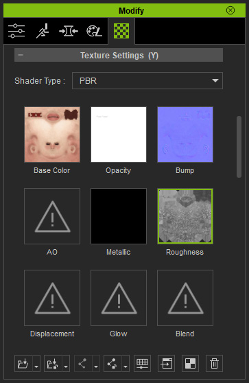

Go to the Texture Settings section, select the Roughness
section.

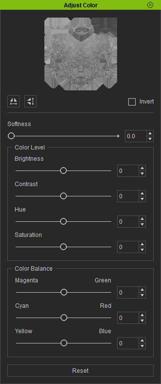

Click the Adjust Color
button to launch the
Adjust Color panel.
Decrease the values of the Brightness settings The skin reflectivity of the head and body
will thus be changed together.
The Metallic map should not be adjusted unless you want the
effect of an oily or metallic skin.
