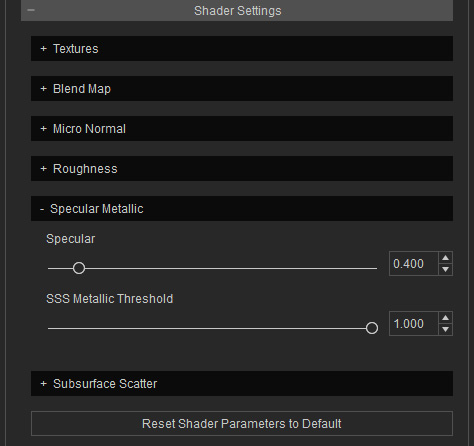

The Specular Metallic parameters are used to define the highlight reflections on the skin. You can find the settings for adjusting the Specular Metallic sub-section under the Shader Setting section in the Modify panel.
- Specular: This value determines the strength of the
reflected highlight on the skin.

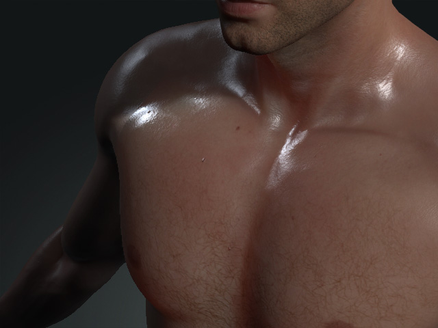

Specular = 0.400 (default)

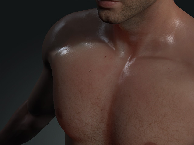

Specular = 5.000
