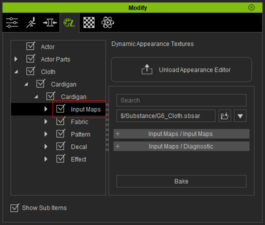

Make sure the cloth is selected. In the Modify panel, go to the Appearance >>
Cloth >> Cloth Item >> Cloth Item >> Input Maps node.

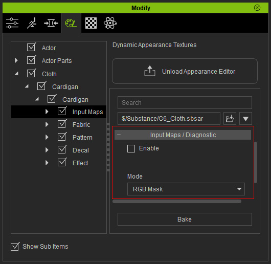

In the Diagnostic section, make sure the Mode drop-down list shows RGB Mask,
then activate the Enable box.

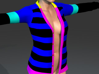

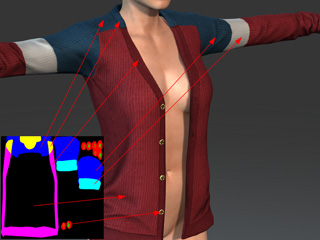

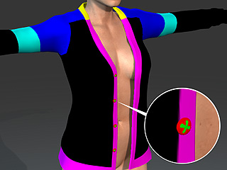

The distribution of the divisions for materials are displayed and covered on the entire cloth
(in this case, the RGB mask image is composed of all Black-RGBCMY colors to divide the entire cloth into several divisions
of materials).

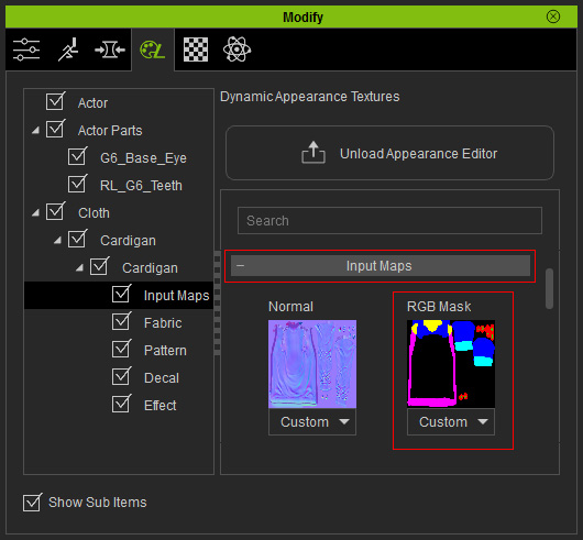

The input mask for these divisions can be found in the Input Maps section >> RGB Mask channel.
This image is made by Reallusion and embedded in the cloth.

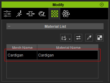

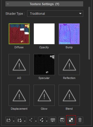

- Switch the Modify panel to Material tab.
Make sure the material is selected.
Click the UV button under the channels in the Texture Settings section.

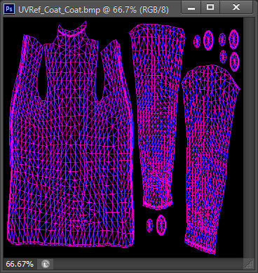

The UV map of the material will be exported to your favorite image editor
(in this case, Photoshop).

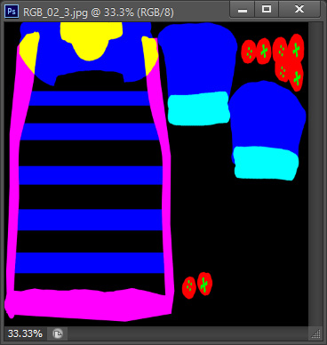

You may then use the image as reference for creating a grayscale texture
to form different areas with Black, Red, Green,
Blue, Cyan, Magenta,
and Yellow colors
(in this case, only the Cyan color is appended onto the black area).
Note:The values for the colors must be accurate for the best results:
Red: (255, 0, 0) or (#FF0000)
Green: (0, 255, 0) or (#00FF00)
Blue: (0, 0, 255) or (#0000FF)
Cyan: (0, 255, 255) or (#00FFFF)
Magenta: (255, 0, 255) or (#FF00FF)
Yellow: (255, 255, 0) or (#FFFF00)

- Select the Cloth in the tree view and click the Activate button at the top-right of the panel to show the sections of adjustable parameters.
- Go to Cloth >> Item Name >> Item Name >> Input Maps layer >> Input Maps section.

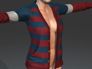

Check out the new distribution caused by the RGB Mask with the settings in the Diagnostic section.
The original distribution of the divisions.
After the distribution is edited.
The fabric materials on the cloth will now be rearranged.
