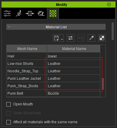

Prepare a clothed character.
- Select the character and check out the material names in the list. In this case, several materials are of the same name.

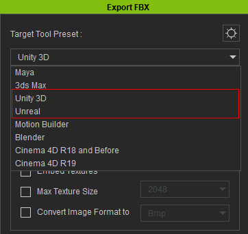

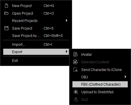

Execute File >> Export >> FBX (Clothed Character) command.
Remember to set the Target Tool Preset to Unity or Unreal in the Export FBX panel.
