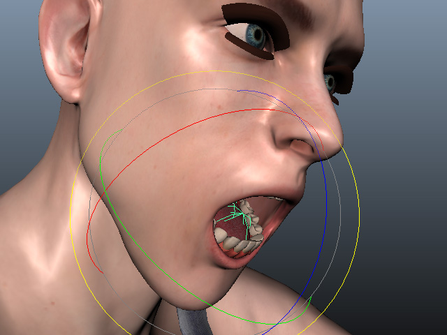

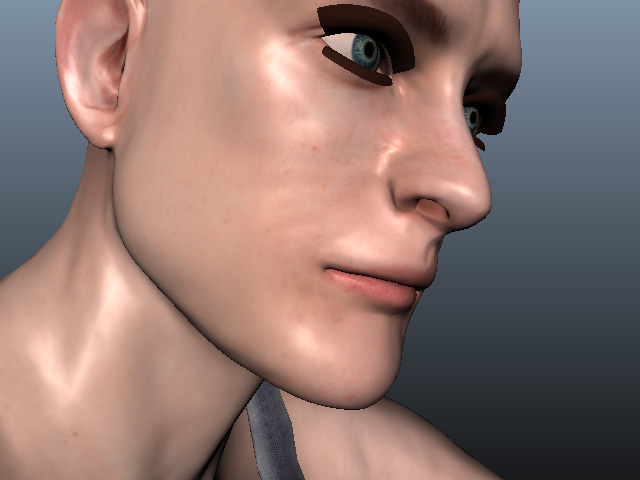

The FBX character imported into 3D tool (Maya).

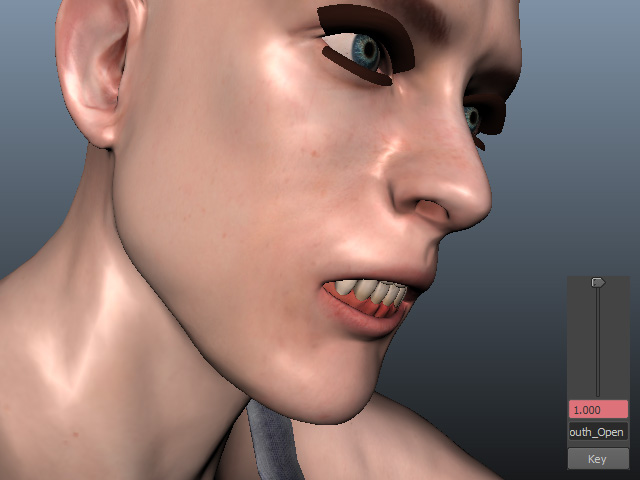

Mouth Open blend shape slider.
Teeth Bone rotation (Tongue Bone is the child and driven to rotate).

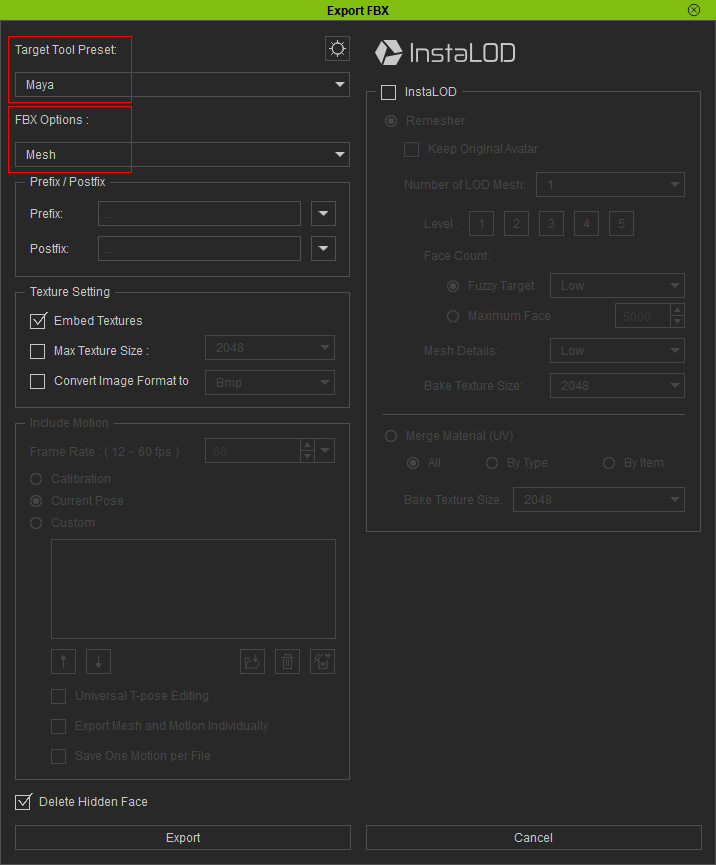

  2. Execute File >> Export >> FBX (Clothed Character) command.
  3. In the following panel, set the Target Tool Preset and FBX Options (Mesh).

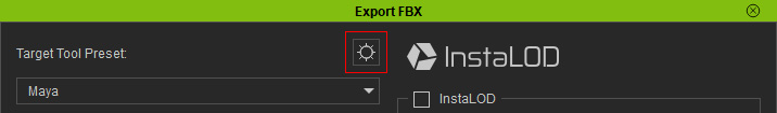

  4. Click the Export FBX Advanced Settings button.

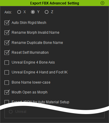

  5. Activate the Mouth Open as Morph box in the Export FBX Advanced Setting panel.

  7. Open the Blend Shape panel, you will find a new slider named Merged Open Mouth, drag it and the mouth, teeth and tongue will be moved at once.
    * Notice that the jaw, teeth and tongue bones stay where they are.
