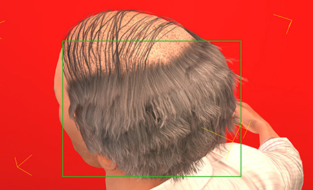

  1. In order to fix opacity white edges or value inaccuracy, increase the GI Settings > Opacity > Alpha Threshold parameter. Alpha Threshold defaults to 30, which is sufficient for most situations and good for scene performance but may not be great for quality.
    Please click Here to view the comparison illustrations.
    However, not all opacity textures are compatible with high Alpha Threshold values. If alpha problems persist, try to decrease the value.

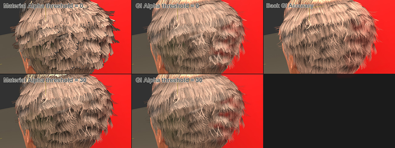

Comparison for Material Alpha Threshold, GI Alpha Threshold, and Translucent GI
Please check out the differences between the Material Alpha Threshold, GI Alpha Threshold and Translucent GI:
