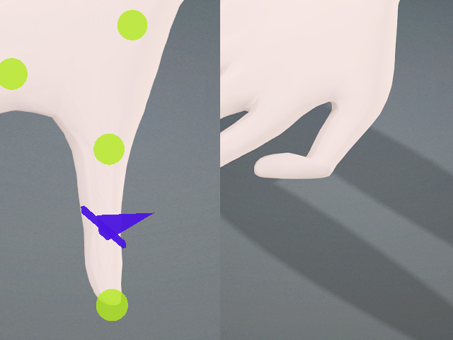

- Drag the guides to properly place them on the knuckles of the fingers.
* Always move the camera to observe and make sure the guides are inside of the model. - Click on the guide indicator and drag on the circle gizmo to align it perpendicular to the thumbnail in order to have the joint bend in the proper direction..
Note: Correct and Incorrect Thumb DirectionsBelow is a comparison of the correct and incorrect thumb orientation:
The direction is set correctly, allowing a natural bend of the thumb.

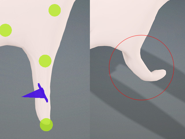

The direction is set incorrectly, causing an unsightly twist of the thumb.
