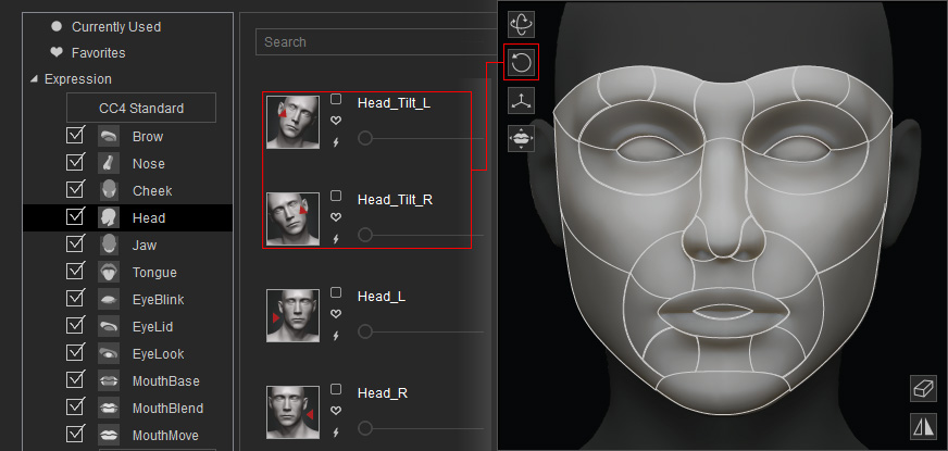

- Head Orientation
- Head Tilting
- Head Move

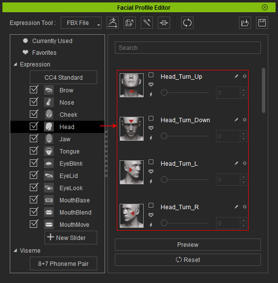

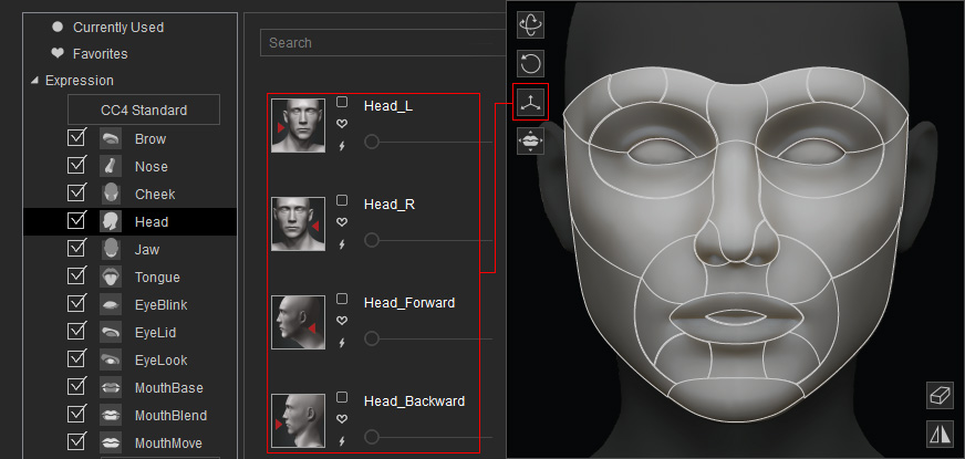

Click the Face Profile Editor button under the Motion Pose tab in the Modify panel.
Select the Head item from the left tree view, the related sliders will be listed in the right pane.

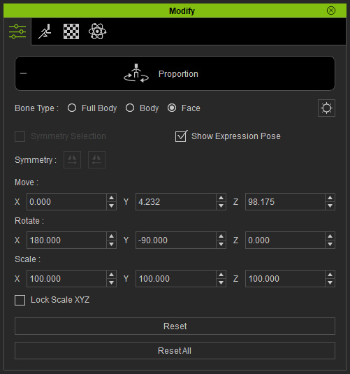

- Click the Proportion button at the top of the panel.
The Modify panel will enter the Proportion Mode.

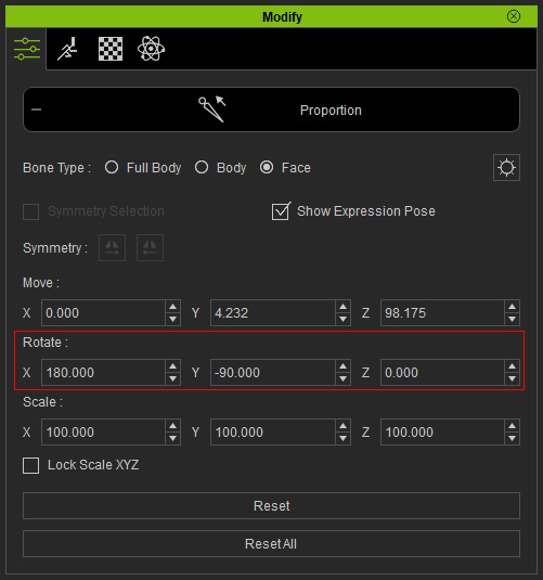

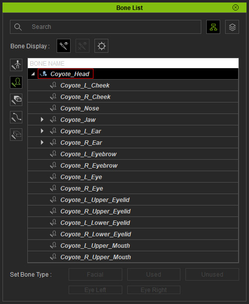

- Pick the Head bone from the Bone List panel (Shortcut: F3).
- Rotate the head to the desired limit direction in one axis.
You can type in specific numbers in the Rotate fields in the Proportion panel.

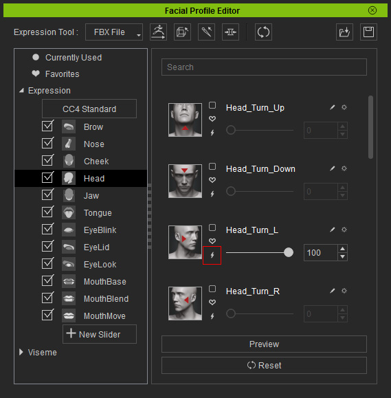

Exit the Proportion mode by clicking the Proportion button again and click the Quick Update button of a slider for saving the limit data.

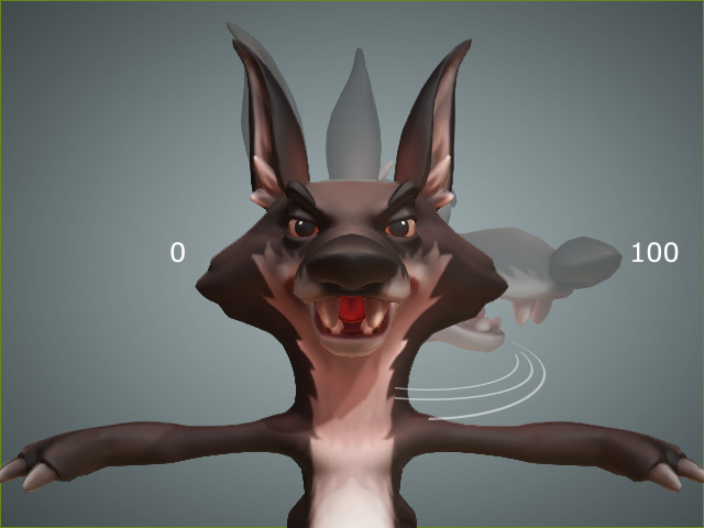

You can drag the enabled slider to check out the result.
- Repeat the step for the rest of the sliders under the Head item and set adequate limit data.
