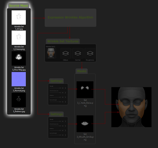

There are five source maps that underpin the expression wrinkle system. These maps are editable to swap and modify the wrinkle patterns. See the Texture-based Details of Expression Wrinkles section for more information.

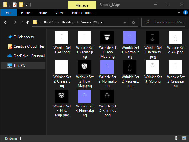

  4. Click the Save All Source Maps button under Modify > Expression Wrinkles > Texture Settings to export all the source maps to a target folder.

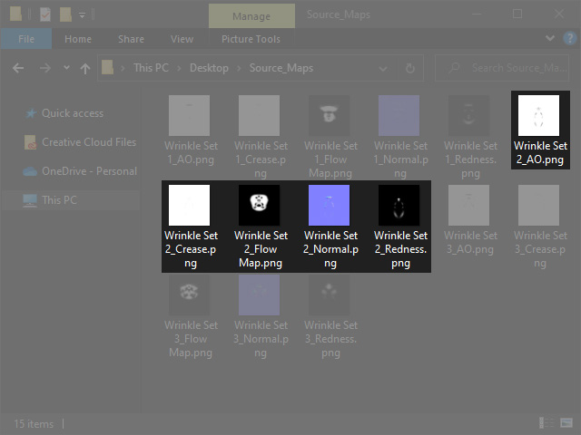

  5. Open the target folder to view the 15 source maps for the three wrinkle sets.
  6. Based on the blue color of the region we chose to edit in step 2, the set we need to edit is Wrinkle Set 2.
    • AO: Used to accentuate the shadows caused the recesses of the wrinkle patterns.

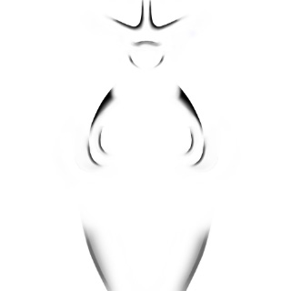

    • Crease: Defines the actual wrinkle lines.

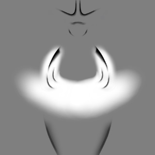

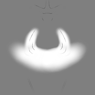

    • Flow Map: Controls the timing of the wrinkle patterns when they emerge on the face. Lighter areas appear sooner than dark areas.

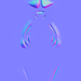

    • Normal: Defines the bumpiness of the wrinkles.
    • Redness: Controls the way in which skin flushes when expressions are made.

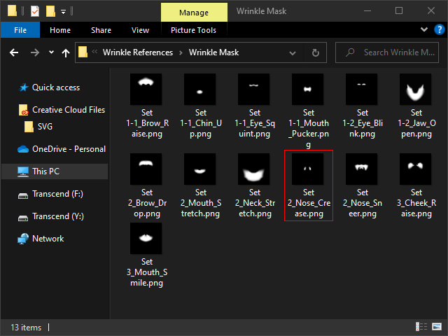

  8. Go back to Character Creator and find the mask for the region, e.g., "Set 2_Nose_Crease.png".
  9. Overlap the mask to the document as the reference layer.
    If the wrinkles span across regions, then the corresponding masks will need to be layered as well.

    • Crease layer:
      Before (crease with mask).
      After (crease with mask).
      Crease without mask.
    • Normal layer:
      Before (normal with mask).
      After (normal with mask).
      Normal without mask.

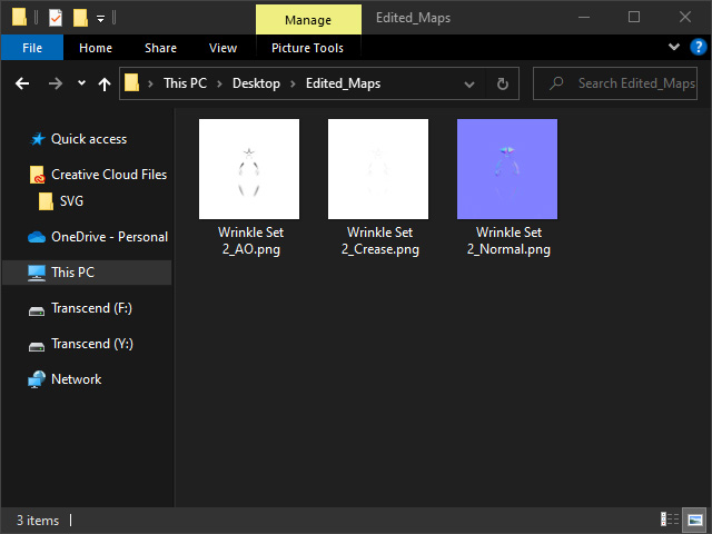

  11. Individually save these layers to image files in PNG format and follow the strict guidelines for the naming convention (You can save them into a new folder or overwrite the ones in the folder for export).

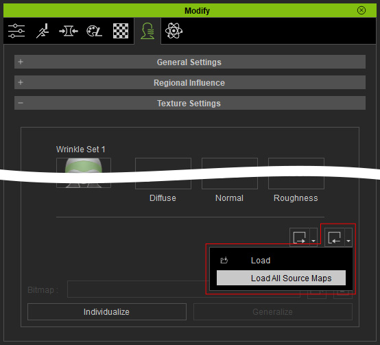

  12. Load the source maps back to Character Creator by clicking on Modify > Texture Settings > Load > Load All Source Maps and select the folder containing the edited maps.
  13. The wrinkles will be updated instantly.
