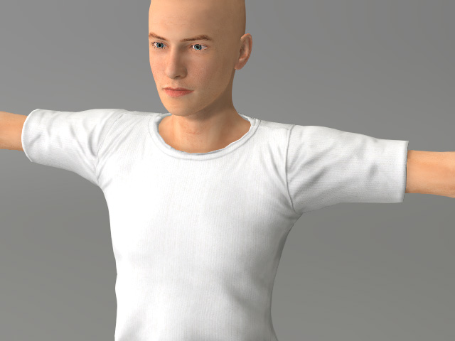

You may sometimes find that the assets do not always fit to the shape of the character's body or head. -

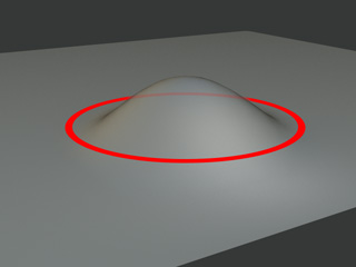

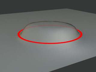

- Falloff (Shortcut: B key + drag with middle mouse button): The blurriness of the edge for each brush stroke.
Falloff = 100
Falloff = 0

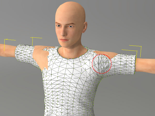

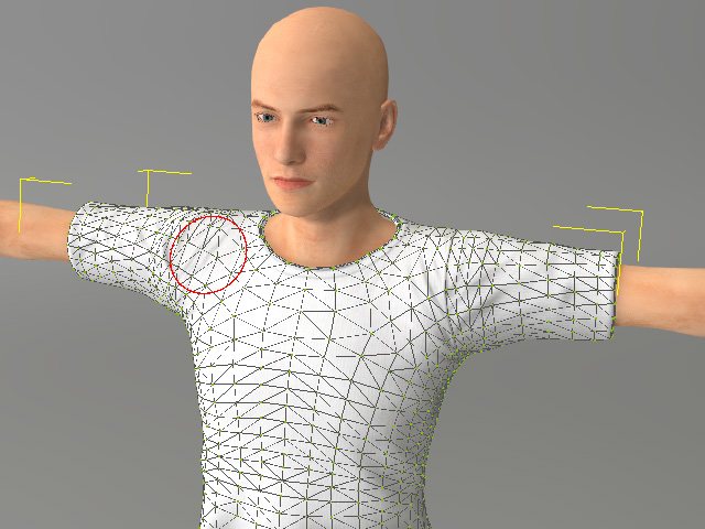

- Hover mouse cursor on the accessory and you will see a circle represents the brush on the surface.
Switch to the Pull Up brush type and paint on the surface.
Repeat painting strokes on the mesh faces until the shape is
satisfactory.
