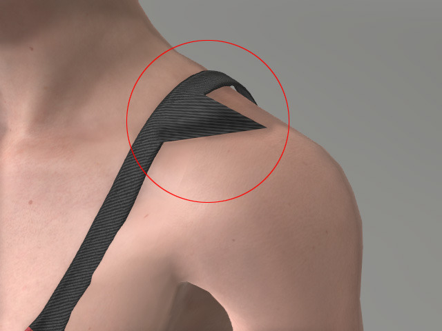

After a cloth is created, you can test the skin weight by setting different poses of the character. When
a flaw happens as shown below, you can set a more accurate value to correct it with the Skin Weights feature.

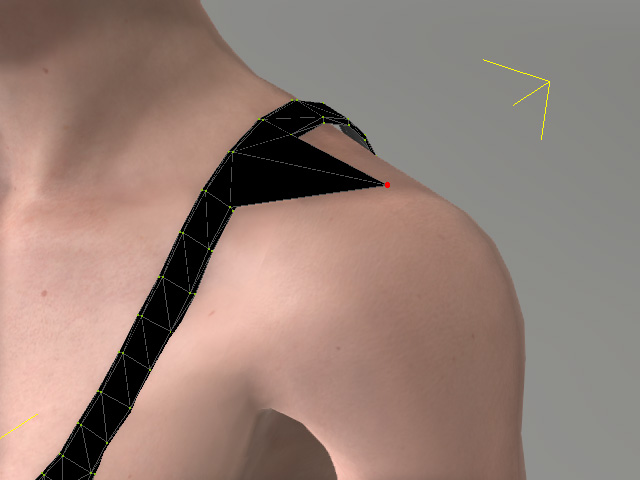

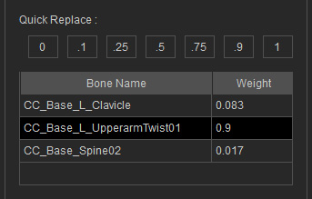

- Pick the vertex
that has incorrectly assigned skin weight.

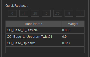

- At the lower part of the panel, you will see a bone list in which the bones controlling these vertices are displayed.
In this case, the CC_Base_L_UpperarmTwist01 bone controls the vertices too much (Weight = 0.9). - Select either one of the adjacent vertices to find the skin weight from that bone.

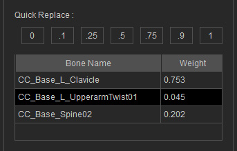

The value of the bone in this case is 0.045.

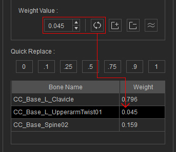

- Pick the vertex with inadequate skin weights again.
- Select the bone from the list to which you want to assign a new value for the skin weight.

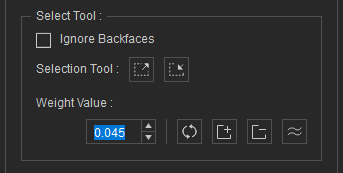

- In the Select Tool group, set a desired value in the Weight Value field.
- Replace
: Click this button to replace the value of the selected vertices with the one in the Weight Value field. - Add
: Click this button to add the value in the Weight Value field to the ones of the selected vertices. - Subtract
: Click this button to subtract the value in the Weight Value field from the ones of the selected vertices. - Smooth
: Click this button to auto smooth the skin weight of the selected vertices with the adjacent vertices.
- Replace
- Click the Replace button to set the value.

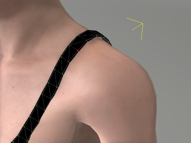

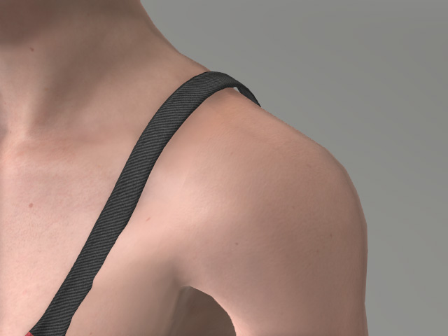

Notice that the skin weights for the other bones will be automatically adjusted simultaneously. - The vertex will pop to the correct position in accordance with the new arrangement of the skin weight from
a different bone.
- Leave the Skin Weights mode view the final result.
