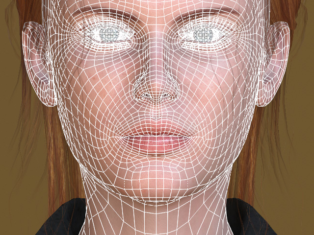

- Create a new project (in this case, the character is created by being imported into Character Creator with the Transform feature).
- Zoom in to the face and display the character in wireframe mode.

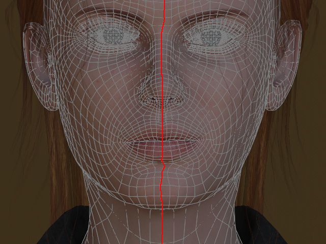

The issues are:- The mid-line is crooked.

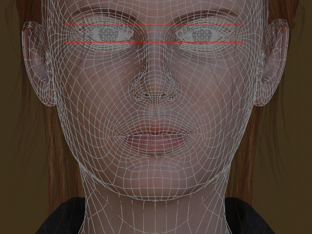

The eyes don't line up vertically.

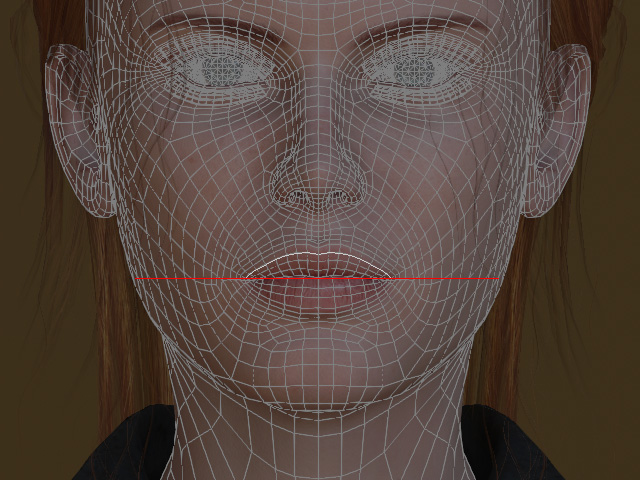

- The rightside mouth corner is higher.

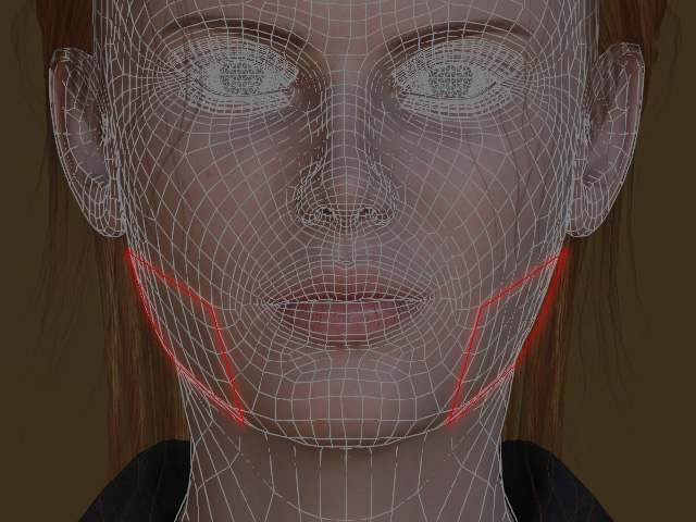

- The right cheek dents
inward.

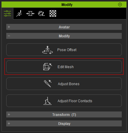

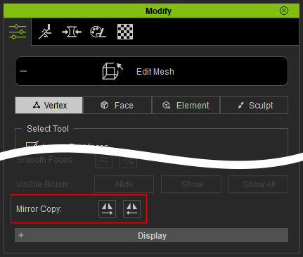

- Click the Edit Mesh button in the Modify section in the Modify panel.
- Switch to either Vertex, Face, Element, or Sculpt mode. Click the Right to Left or Left to Right button of the Mirror Copy (in this case, Left to Right).

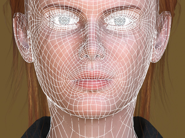

- Exit the Edit Mesh mode.
- The target vertices
will be re-positioned to their default locations.
- The mid-line is
now straight.
- The eyes are on the same horizontal
plane.
The mouth corners are aligned.
- The cheek
volumes are the same size.
- The mid-line is
now straight.
