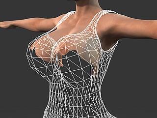

When you increase the size of the inner meshes of a skin poking through the outer layers, you can use the following method to hide the piercing parts:
Create a new project and dress the character.
Increase the size of the entire body or specific body part. Sometimes the
partial mesh of the skin maybe poke through the cloth, as the following
illustration shows.
You can turn the upper layer of the mesh into wireframe mode to get a better view of the penetration.

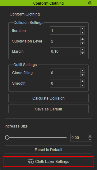

Select the cloth at the topmost layer (in this case, the blue dress).
Execute the Edit >> Conform command to launch the Conform Clothing panel.
Alternatively, click the Conform Clothing button on the Modify Tools toolbar.
Activate the Hide Inner Mesh box at the bottom of the panel.
The meshes poking through the cloth will be become hidden.
