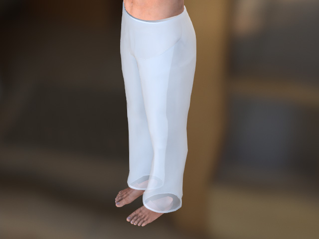

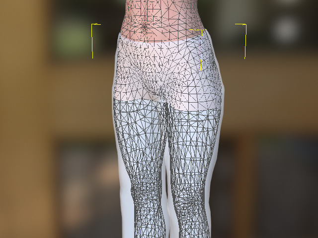

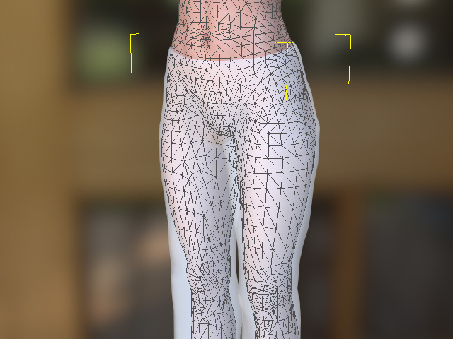

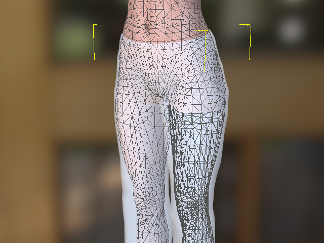

The cloth automatically turns into X-ray mode; and the skin shows the wireframe, for viewing the cloth and the skin simultaneously.

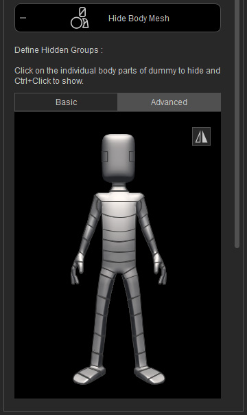

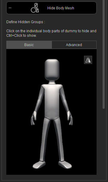

- You will see the dummy pane
in the panel. There are two modes for the dummy pane: Basic and Advanced.

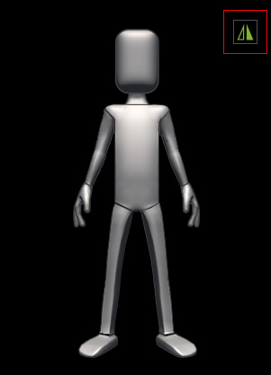

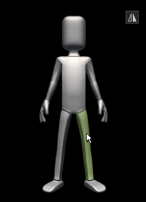

- In the Basic mode, click on the areas of the dummy's body
for hiding.
If you click on the Mirror button, then the symmetrical areas will be hidden together when you click on either side.

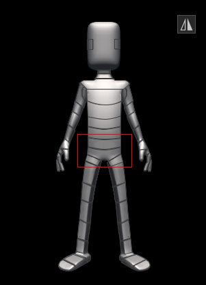

- In the Advanced mode, click on the detail areas to
show/hide more areas.

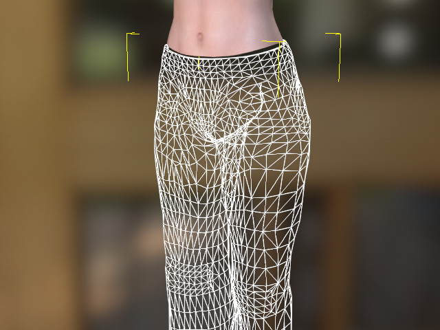

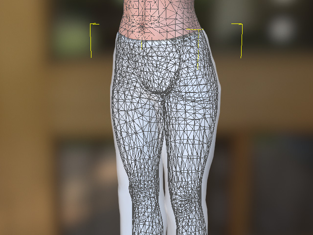

* Keep in mind that holding the Ctrl key and click on the dummy body parts makes it visible again. - Leave the Hide Body Mesh Tool by clicking the button again. Switch the cloth to wireframe mode and you can find the inner skin meshes are hidden accordingly.

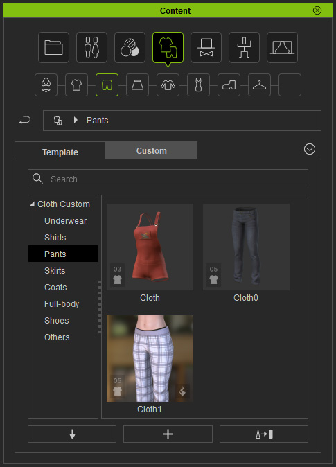

- You can save this cloth to the Content Manager.
The hiding information will be saved along
with the cloth as well.

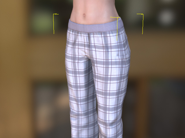

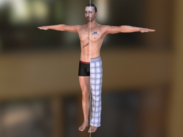

- Create a new project with a new character.
- Switch the cloth to
X-ray mode and the hidden results
will be identical to the previous settings.
