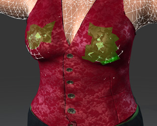

After you use the Conform Clothing feature, you may encounter mesh
penetration as shown
below:

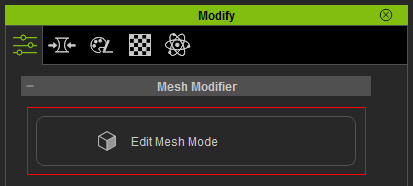

Select the mesh whose faces poke through the outer layer cloth, and enter the Edit Mesh Mode by clicking the Edit Mesh Mode button
in the Modify panel >> Edit tab >> Mesh Modifier section.

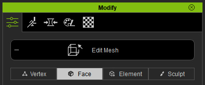

- Switch to the Face tab.
- Select the piercing faces.

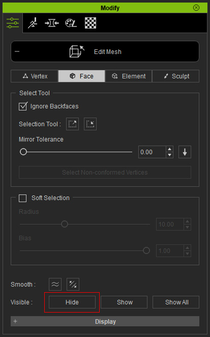

Click the Hide button to conceal these mesh faces.

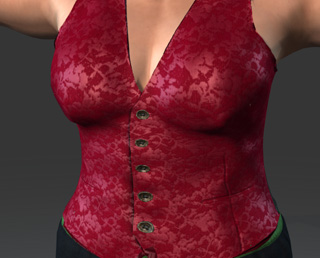

Click the Edit Mesh Mode button again to view the result.
Note:Click on the Show button in order to show the meshes that you do not want to hide.

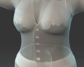

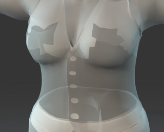

- The changes of the inner mesh faces in X-Ray mode are shown below:
The inner mesh faces before the Manual Hiding.
The hidden range is expanded after this feature is applied.
