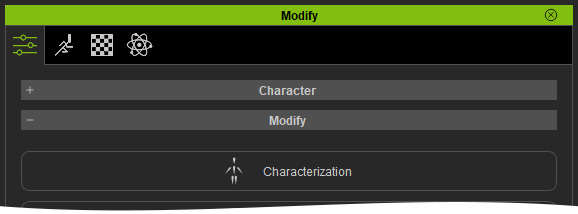

Enter the Characterization mode.

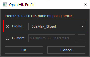

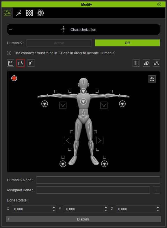

- Click the Load HIK Profile button.
Expand the Profile drop-down menu.
Select a preset from the list according to the source 3D tool of the loaded character. Click the OK button.

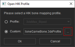

If you want to use a previously saved 3dxprofile, then choose the Custom radio button and click the ... button to load in the file.

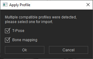

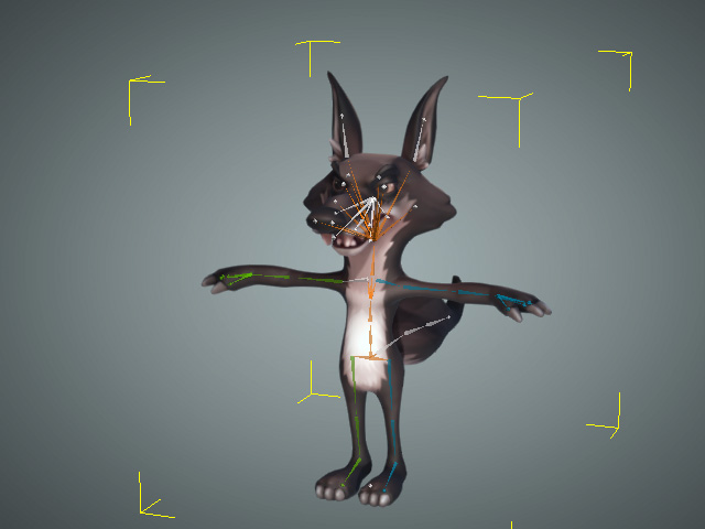

- You will be asked to choose the T-pose or Mapping method. Activate both checkboxes and click the OK button.
The bones will be set to T-pose and instantly mapped
(Please note that if the selected preset does not match the bone structure of the character, then you will
only get a partial-mapping or no mapping result).

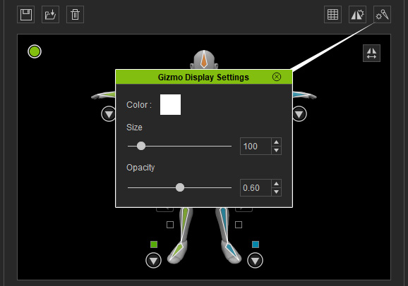

Note- Click the
Bone Settings button to adjust the bone color and size.

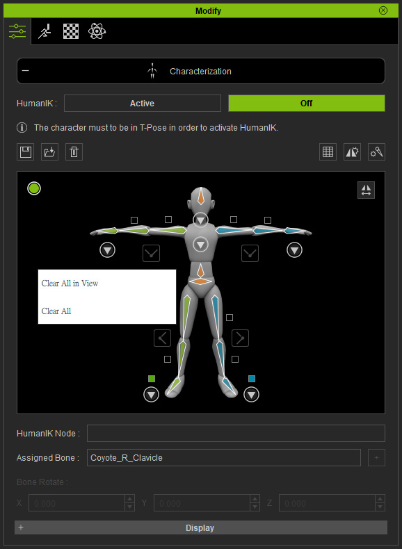

- You can right-click on the black area of the pictogram to clear all mapping result.
- Clear All in View: Only clear all mapping results in current view (in this case, 15 bones in the pictogram).
- Clear All: Clear all mapping results in different view, including the spine, neck, fingers, and toes bones.
- Click the
