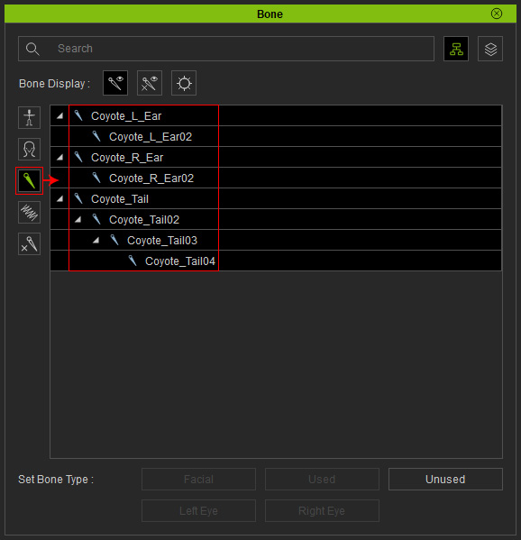

  2. Open the Bone List (Shortcut: F3), and use the filter buttons to show the Unused Bones only.

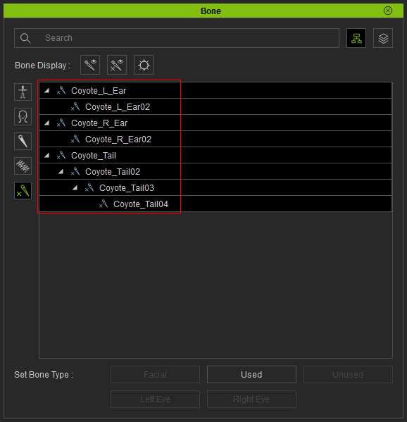

  3. Select desired Unused Bones. Click the Used button at the bottom of the panel.

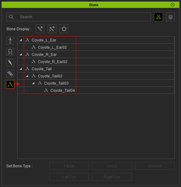

  4. Use the filter button to show the Used Bones. As you can see, the bones selected in the previous step become Used Bones.
