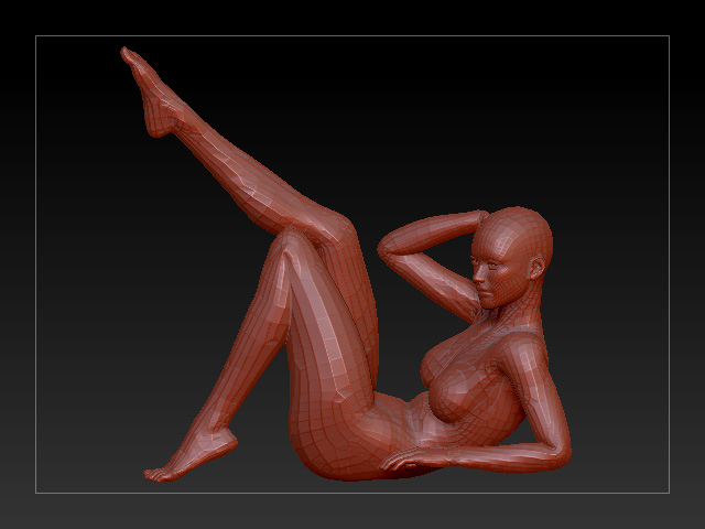

In addition to sending a model in T-pose to ZBrush for further sculpting, you can also apply a pose so that the character sent to ZBrush strikes a certain pose rather than just assuming a T-pose or A-pose.

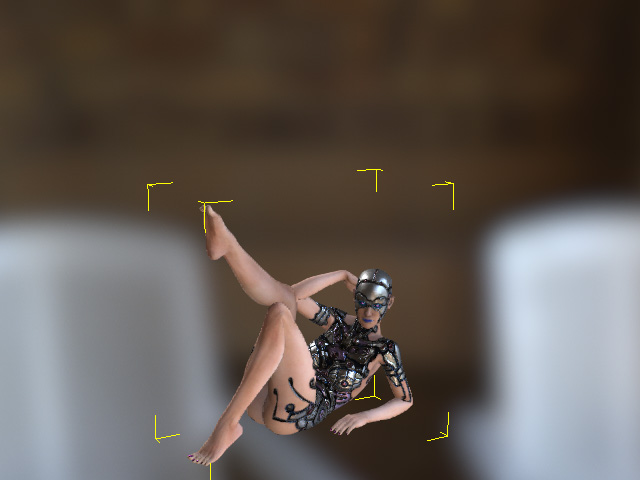

- Apply a pose to the character with template from the Content Manager or by the Edit Pose panel (Shortcut: N).

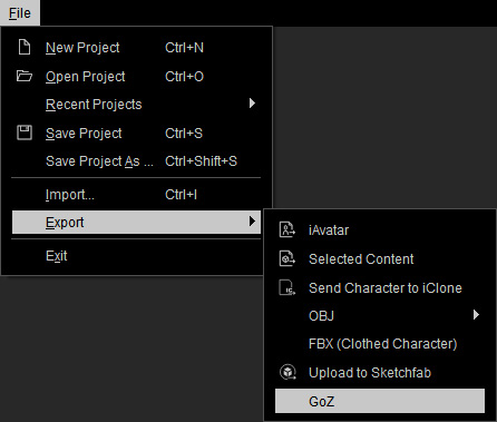

Alternatively, access the File menu >> Export >> GoZ command.

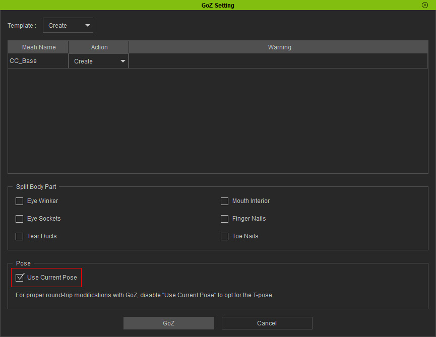

- Activate the Use Current Pose box and click the GoZ
button to send the character with custom pose to ZBrush.
Refer to the GoZ Setting User Interface Introduction section for more information.

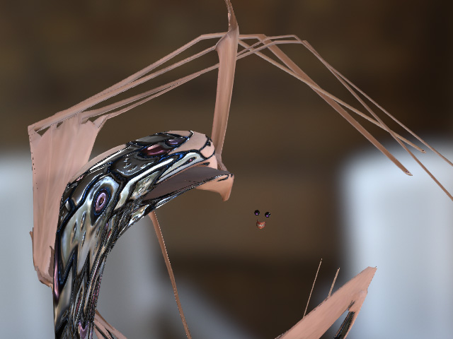

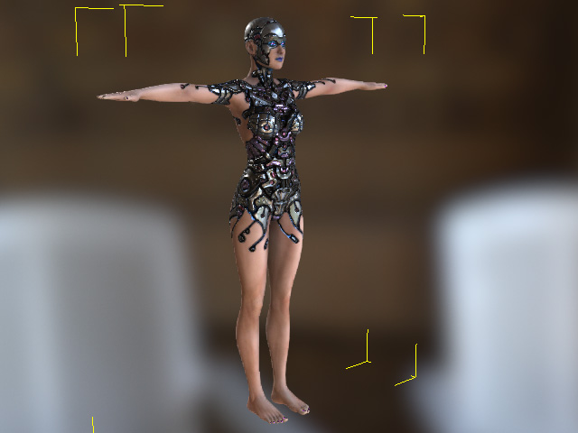

Note:The character sent to ZBrush with custom pose can not be brought back to Character Creator for further editing because Character Creator is a T-pose based application. Doing so will result in minor to severe mesh distortion:
