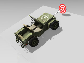

The Look At feature of the P-o-A is based on the local
coordinate of the pivot.

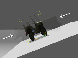

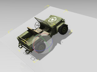

- Move - World Mode: In Character Creator, you are allowed to move a P-o-A in World Mode
with the World Move
tool; which means to move the P-o-A
along the X, Y, Z of the
world coordinate.

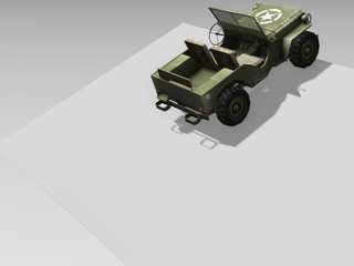

You can not easily move the jeep along the ramp with World Move tool.

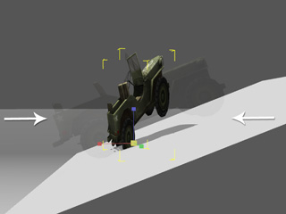

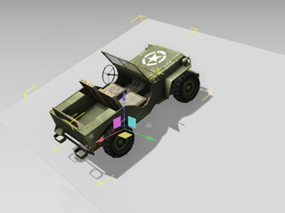

- Move - Local Mode: You can move a P-o-A in
Local Mode
with the Local Move
along the direction of the P-o-A.
Use the Local Move tool instead.

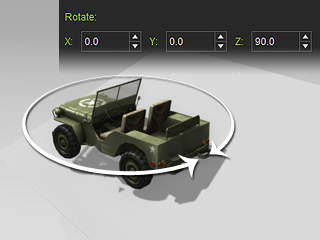

- Rotate: The Local Rotate
tool is for Local Rotation only.
If you want to rotate the P-o-A according to world coordinates, you may either switch to the World Rotate
tool, or go to the Modify panel >> Attribute tab >> Transform section,
and enter values into the Rotate numeric fields.
Local rotation only.
Type in values for world rotation.

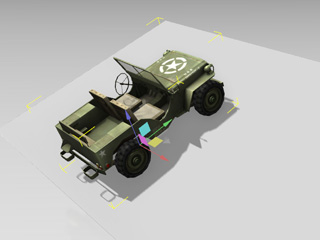

- Scale: The Scale
tool is also for Local Scale only. This can prevent the P-o-A from
skew or distortion when you scale it.
The prop is scaled by the Local coordinate.
(No skew)

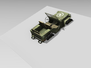

The prop is scaled by the World coordinate - not used in Character Creator.
(Skew occurs)
