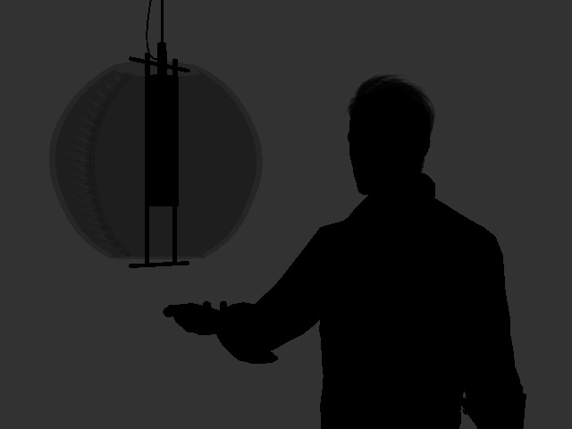

The PBR materials without any light.

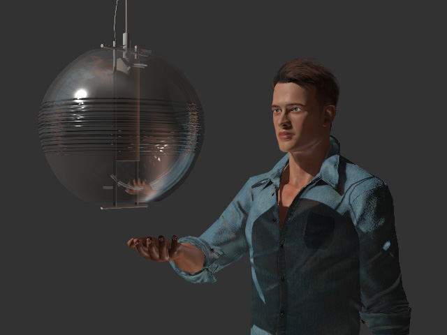

The PBR materials reflect the lights (Self-cast shadows).

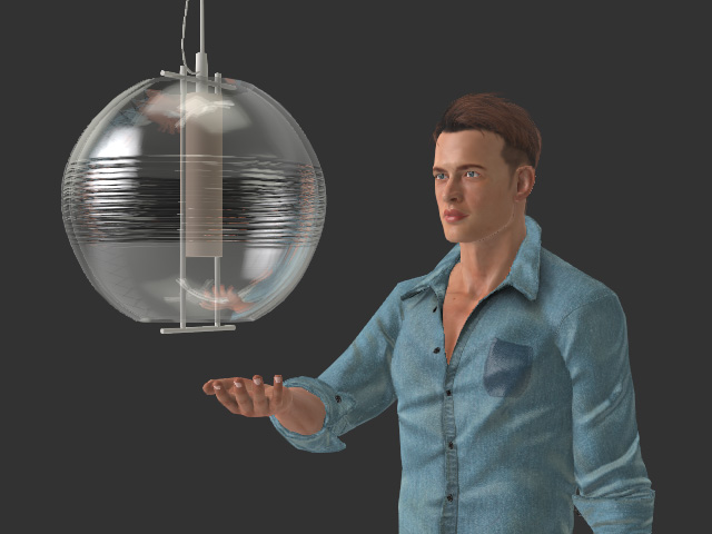

The PBR materials reflect the IBL (No shadows).

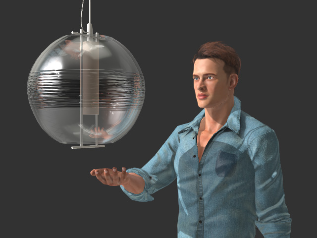

The PBR materials reflect both the light and IBL (PBR and shadows).

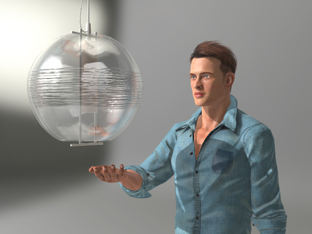

Turn the Sky sphere on for better observation of the direction of the IBL (Sync Sky Image is ON).
