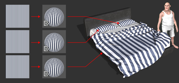

Concept

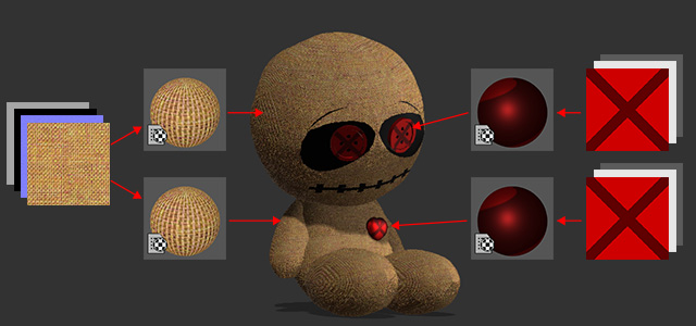

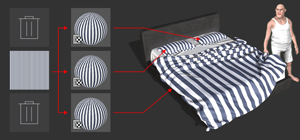

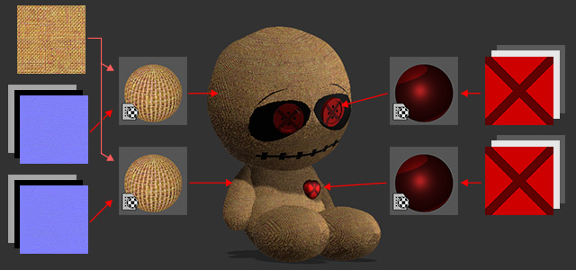

Take the Diffuse textures of the bed prop shown below as an example, the texture and the materials relations are:

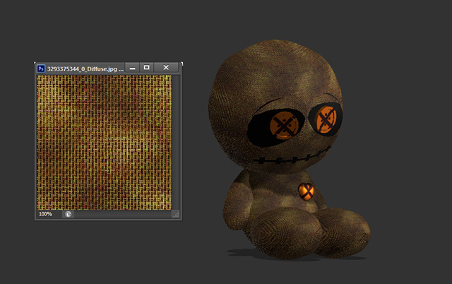

You must edit the texture one by one in order to have the same appearance for the sub-meshes of the object:

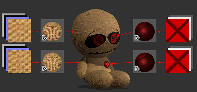

By linking all of the identical textures, only one image will be used as the source for all of the linked Diffuse channels:
You only need to edit one texture to propagate the changes to all of the sub-meshes:

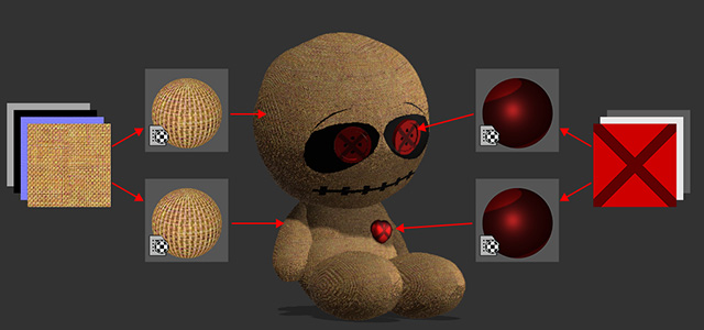

Link Textures - Object Level
  1. Apply a prop with multiple materials, and these materials are assigned with individual but identical textures (take the Base Color Channel as an example).

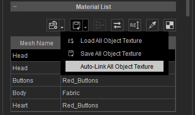

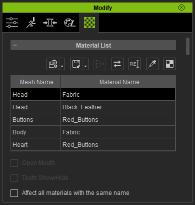

  2. Select the prop and pick any of the materials in the Material List.
  3. Executing the Auto-link All Object Texture command from the drop-down list shown in the illustration below:

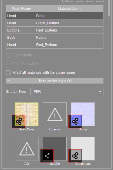

    Character Creator then scans this prop, finds the identical textures in all the channels, keeps only one and removes the rest, and links the channels together.

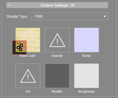

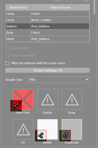

  4. Check out the linked channel image. You will see a link icon at the bottom left corner of the channel slot.

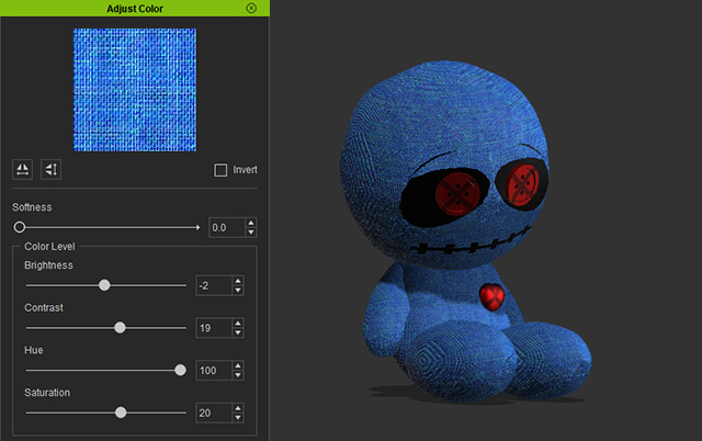

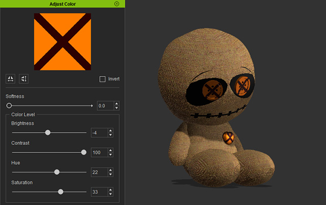

  5. When you adjust the texture by Adjust Color panel or any image editor, the materials with the liked textures will be synchronously adjusted.
    Adjust Color panel:
    Image Editor:

  2. Select the prop and pick the materials you want to do the texture-linkage method in the Material List, in this case, the Fabric material.

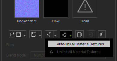

  3. Click the Auto-link All Material Textures button under the channels.
    Character Creator then keeps only one of the identical textures and removes the rest, then links the channels together.
  5. When you modify the texture with the Adjust Color panel or any image editor, the materials with the liked textures will be synchronously adjusted.

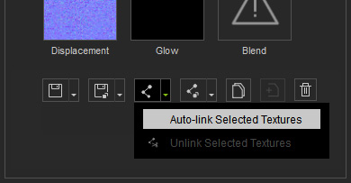

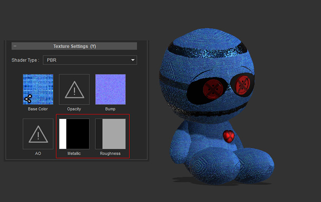

  3. Click the Auto-link Selected Texture button.
    Character Creator then links only this texture.

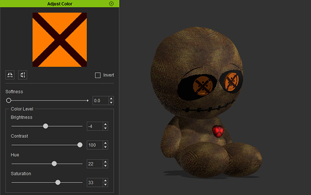

  5. When you adjust the linked texture by Adjust Color panel or any image editor, the materials with the liked textures will be adjusted together.
    Take the Adjust Color panel as an example:
  6. The textures no linked can be separately adjusted.
    Take the Image Editor as an example:
