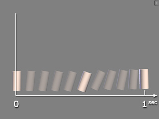

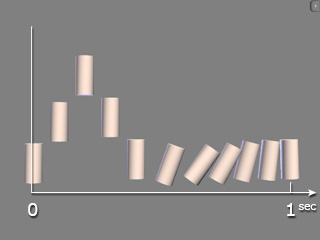

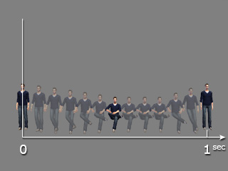

Given two example animations, the transforms and poses in one-second intervals are as below:
Transform frames. |
Pose frames. |

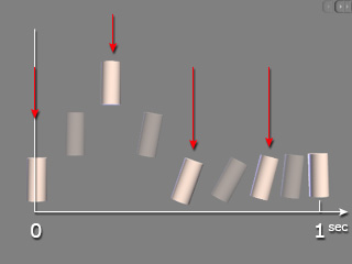

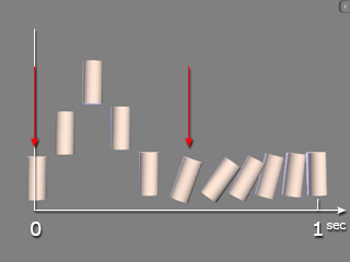

If you set a sampling rate to two, for example, then Character Creator only extracts two times per second to form a new animation or motion, while ignoring the transform data or the poses in between the extracted ones; which will generate a very rough animation or motion which may look very different from the original animation or motion.
Sampling times from the origin |
New animation or motion |
Only two transform data are extracted from the original animation and the rest ones are ignored. |
The in-between animations will be calculated according to the samples and be automatically interpolated (with poor result). |
Only two poses are extracted from the original motion and the rest ones are ignored. |
The in-between motions will be calculated according to the samples and automatically interpolated (with poor results). |
