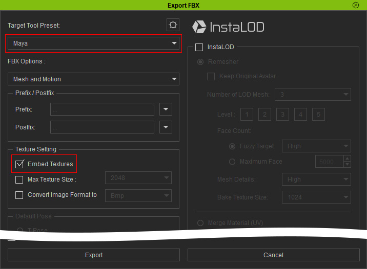

  2. Execute File >> Export to Fbx >> Clothed Character command.
  3. In the following panel, select either Target Tool Preset and activate the Embed Textures checkbox.
  4. Click the Export FBX Advanced Settings button on the top of the panel.
  5. In the Texture and UV section, make sure the UDIM checkbox is activated.
  6. Click the Export button on the Export FBX panel to export the character.

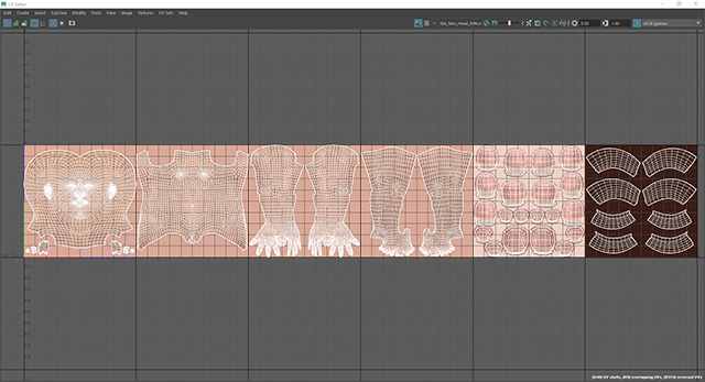

    UDIM result in UV Editor; the polygons are separately put in different grid

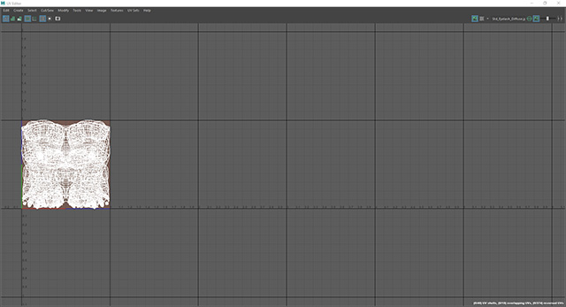

    Non-UDIM result in UV Editor; the polygons are all overlapped together
