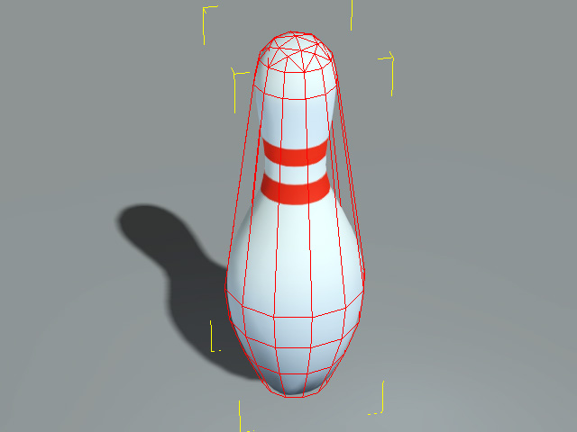

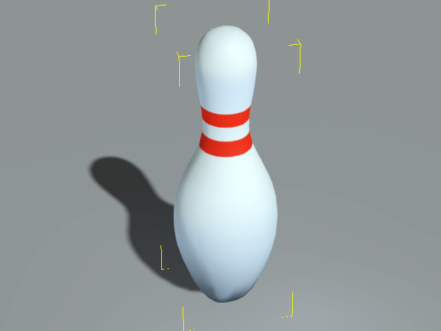

Show Collision Bounding Color
Activate or deactivate this checkbox to show or hide the physics bounding boxes of rigid bodies in the scene. This is useful when you want to perform further adjustments without being obstructed by the bounding boxes for the rigid bodies, such as texture or animation editing.
Show Collision Bounding Color = On
Show Collision Bounding Color = Off

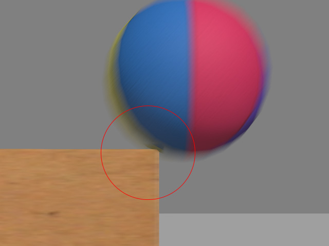

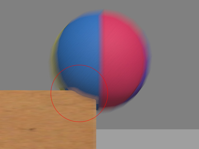

Continuous Collision Detection
When the rigid bodies in a scene move very quickly, they can often penetrate each other, especially when there are numerous rigid bodies involved in the animations. Activating this checkbox will diminish the chance of penetrative issues. However, it can also greatly increase the load on system resources.
Continuous Collision Detection = Off
Continuous Collision Detection = On

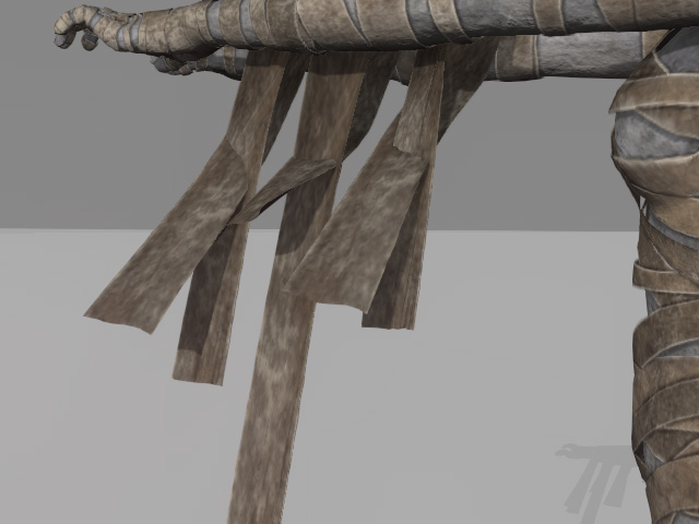

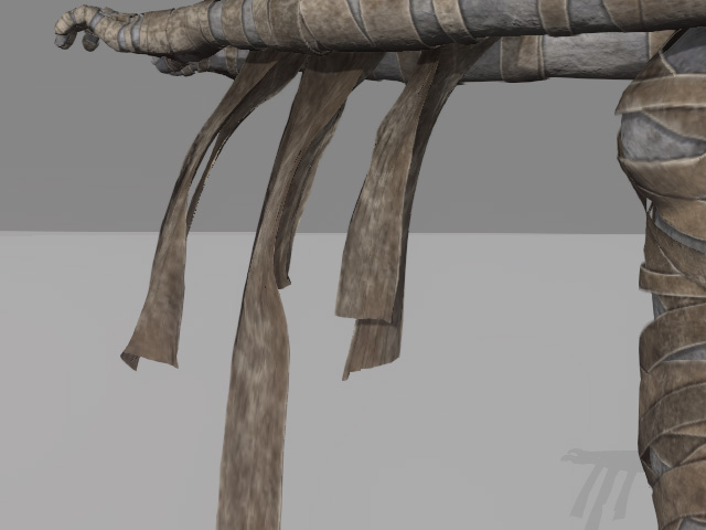

If you deactivate this box, then the animations of the soft-cloth will not be kept after simulation. Activate it in order to keep the simulated result. You can deactivate the physics characteristics for the soft-cloth to relief the burden of the system resources while have it animate.Soft vs. Soft Collision
This setting determines if the soft clothes in the scene collide with each other or not. Activate to achieve the best simulated result to reduce penetration issues. However, keep in mind that this will increase the load on system resources.
Soft vs Soft Collision = Off
Soft vs Soft Collision = On
