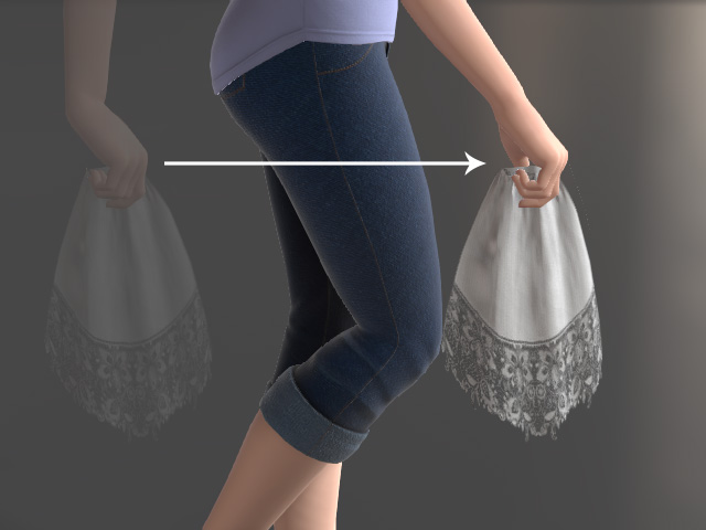

Here is a soft-cloth (pinned by two corners) that stops abruptly at a certain time.
Set various inertia values to determine if you want the un-pinned part of the cloth to keep moving in different levels when the entire cloth comes to a standstill.
Inertia = 0 The soft cloth does not go beyond the stop position. |
Inertia = 20 The soft cloth goes slightly beyond the stop position. |
