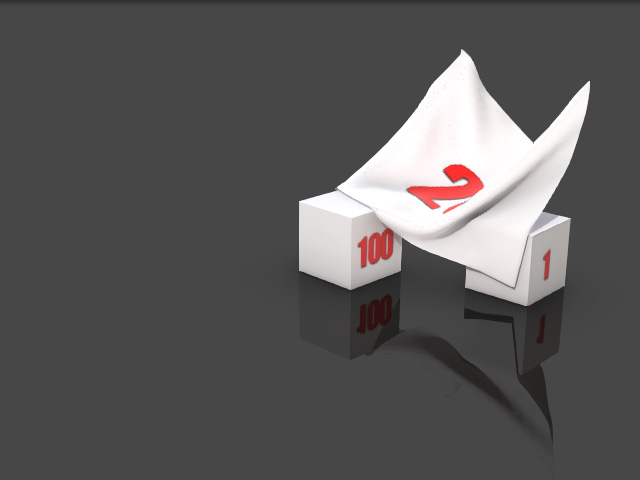

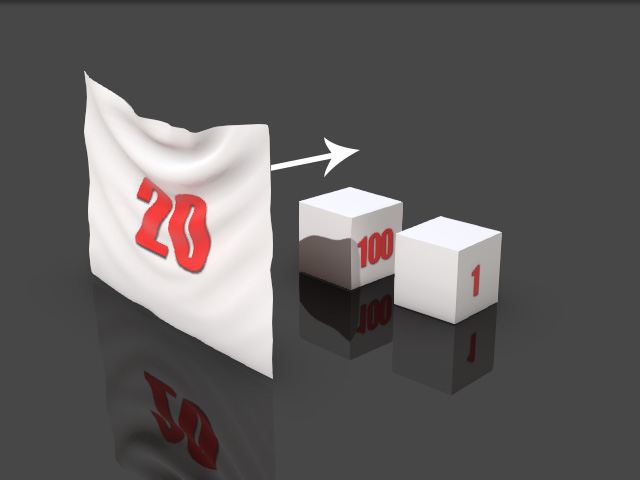

A soft cloth (20) moves toward rigid bodies. |
The heavier object (100) stays. The lighter object (1) is pushed away. |

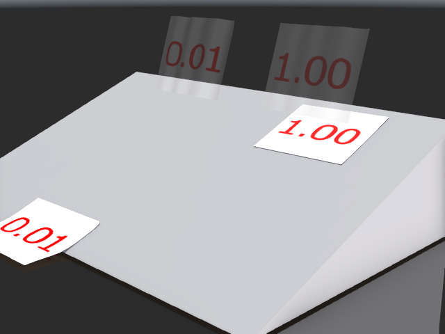

Friction
Friction is the roughness of a surface which generates resistant force and causes a change in speed in objects that slide over it.

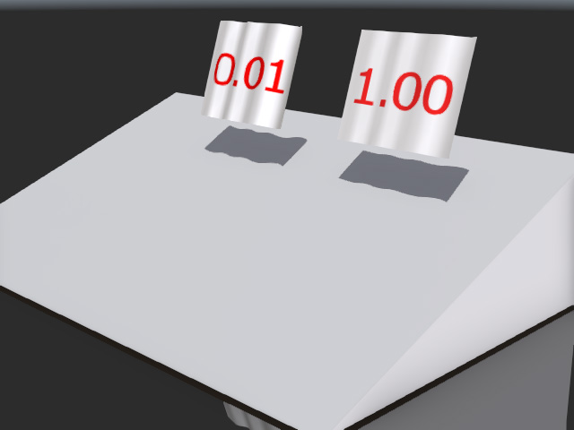

Two planes slide down a ramp. (Ramp's friction = 30) |
The plane with higher friction slides slower. |

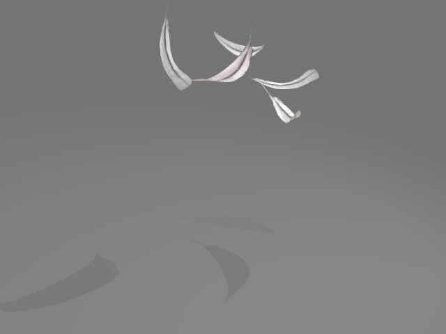

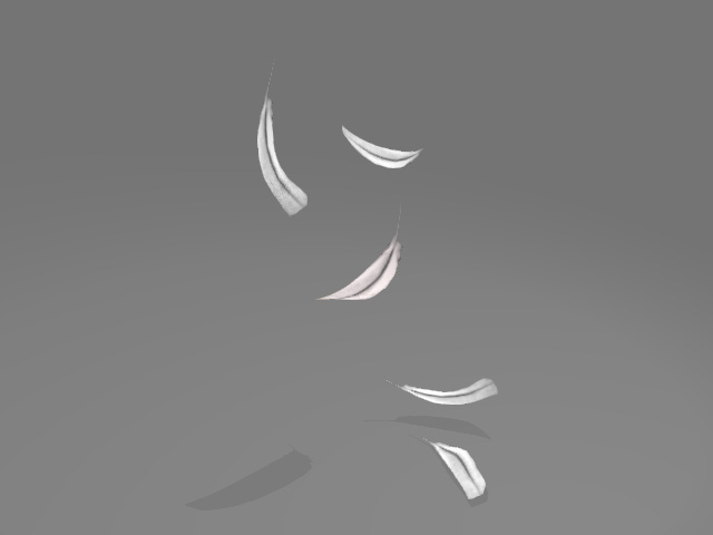

The Damping value affects soft cloths tremendously. You can use this value to make a feather or a cloth slowly fall down.
Feathers (soft cloth) with different damping values. |
They fall down at different speeds. |
