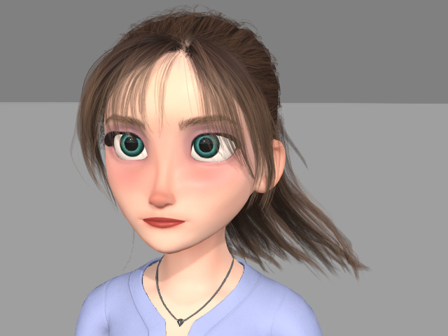

Force
The Force settings draw the soft-cloth to a given direction while neglecting the global gravity of the project. It is a constant force which may or may not cause wrinkling due to the non-uniform qualities like those exhibited in wind.
Create a project with soft cloth objects (in this case, the character's hair).

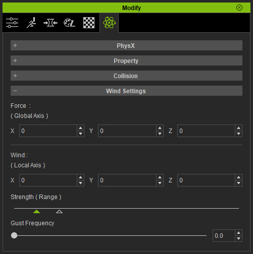

- Make sure the cloth is selected and go to the Modify > Physics tab.
In the Wind Settings section, set the X, Y and Z
values in the Force group (in this case, the [X, Y, Z] =
[1000, 0, -500]).
Play back to simulate the soft cloth animation.
The soft cloth will have a uniform reaction according to the direction of the force assigned.
Note:- The higher the values are, the stronger the initial force will be.

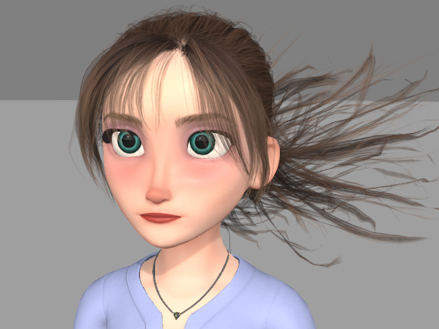

Wind
Unlike the Force setting, the Wind will produce intermittent 'gusts' which simulate the reaction of soft cloth in the wind.
Please note that the use of the X, Y and Z axes is the same as described in the previous section.

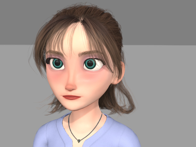

Gust Frequency
The value of the Gust Frequency determines the number of occurrences of wind gusts in a certain period of time. A higher value dictates that gusts of wind will happen more often and vice versa.
Gust Frequency = 5.0 |
Gust Frequency = 60.0 |
